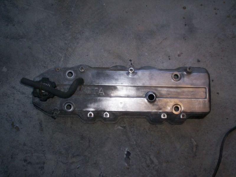

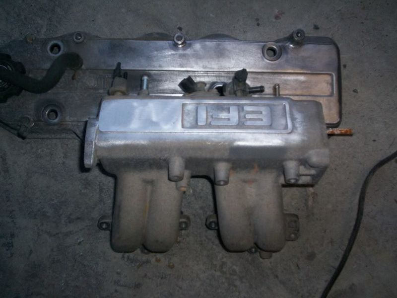

another question what is the stock intake made off cast alum..can it be welded...and also whats is the best stuff to clean and polish the stock alum vavle cover

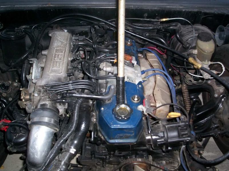

here is what it looks like and the blue is not my color
and what im going for

Just use paint stripper to remove the paint, it will clean up the intake as well. You can have both polished out ,or power coated .

the best thing to polish them with is a da and sand paper. progress to finner grit, then start with the polishing. should take you a couple days to do properly.

the one im cleaning has no paint it alum as you can see in the pic...the blue one the old own painted and im not using it...i asked about the alum not removing paint...how to clean it

SAND PAPER AND A DA.
the castings are very rough if you'll inspect closely, you cant just polish it or it'll look like ass.
clean and start your polishing at the same time.

^^yeah just like kdc said, your gonna have to sand all the 'texture' out of it until its smooth. or just get it powder coated. unless you have the drive to really keep up on a polished valve cover.

i sanded mine smooth before i got it coated. comes out nicer.

id rather have it shine like chrome or billet ....i cant cover somehting like that up
