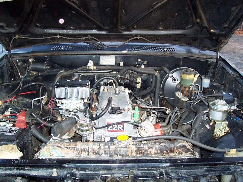

Anyone running a single weber carb on their 22r? I'm at a loss on the vacuum line setup, I don't know what I need as far as vac for the carb, distributor, BSBV valve and the intake.

I have the pvc running to the intake where the EGR tube used to go, The valve cover vent is going to the bottom of the air filter housing, and the dist. vacume advance comes off the metered vacume connection on the side of the carb. My carb is a 36DGEV. I capped off the EGR with a pipe cap and did away with tha bulky vac can usually found under the carb by the a/c compressor. I also blocked off all of the old vac fittings on the intake and the EGR.

Ok, that helps a little. My vac. advance has 2 ports. Does one get connected and one capped??

I capped of the one farthest away from the dist., or was it the closest, heck, I just can't remember now and my truck is at home. Hook up one, put a timing light on when you get it running, rev it up and if the timing advances, you got the right one. If it doesn't, then put the line on the other one. Sorry I can't remember, and I can't tell in my picture very well.
