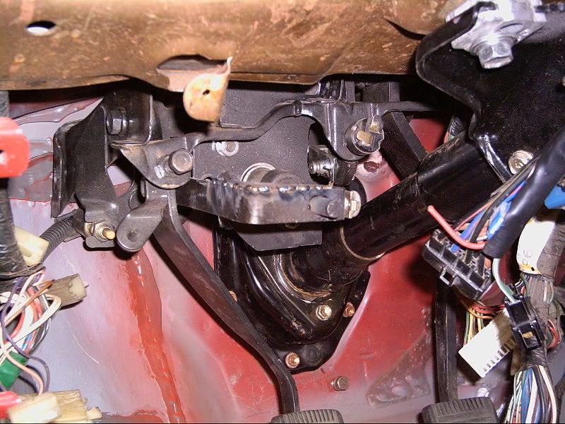

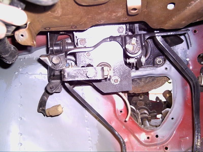

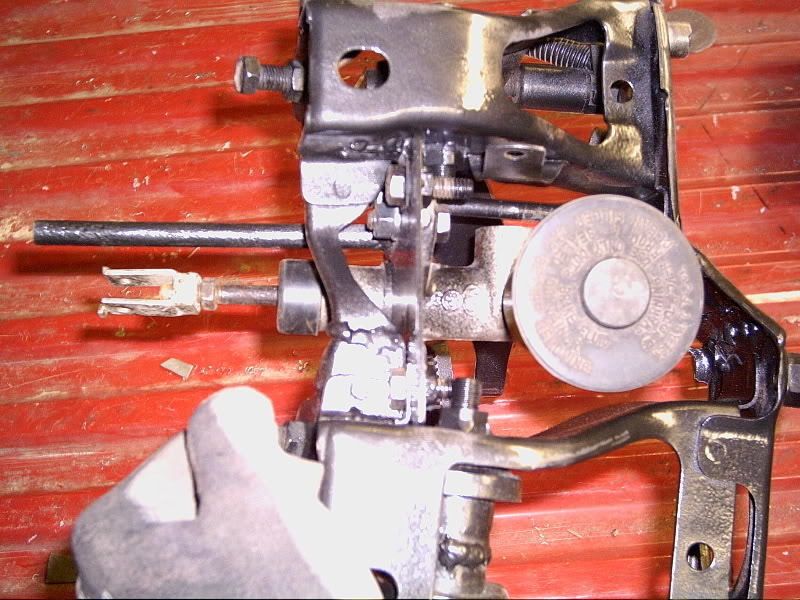

m_i_zombie
Its not that difficult to do as long as you think it through.
This is how I made my clutch and brake pedal setup.
I used an old clutch resivoir fram a ranger and have it mounted in the cowl. Its basically a remote funnel/ resivoir, it runs straight into the cap on my master cylinder.

that dosent look that hard to do, just a little time

It wasn't that hard once I started on it. Since I moved my booster over 3.5in I sectioned the pivot rods on top of the pedals to move them back to stock location and shortened the pedals.
