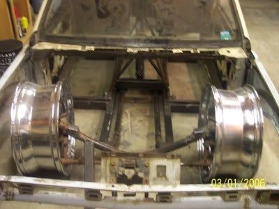

im on 20s with a big tire but i still have more travel when im laied out so i can lay a 22, i just notched the lower arms and fliped the uppers from side to side( so they r upside down) or you can judt pie cut the uppers for the ball joint angle u will just loose lift but since your not body droped in to the rocker you should be ok. i just am limited on my lift

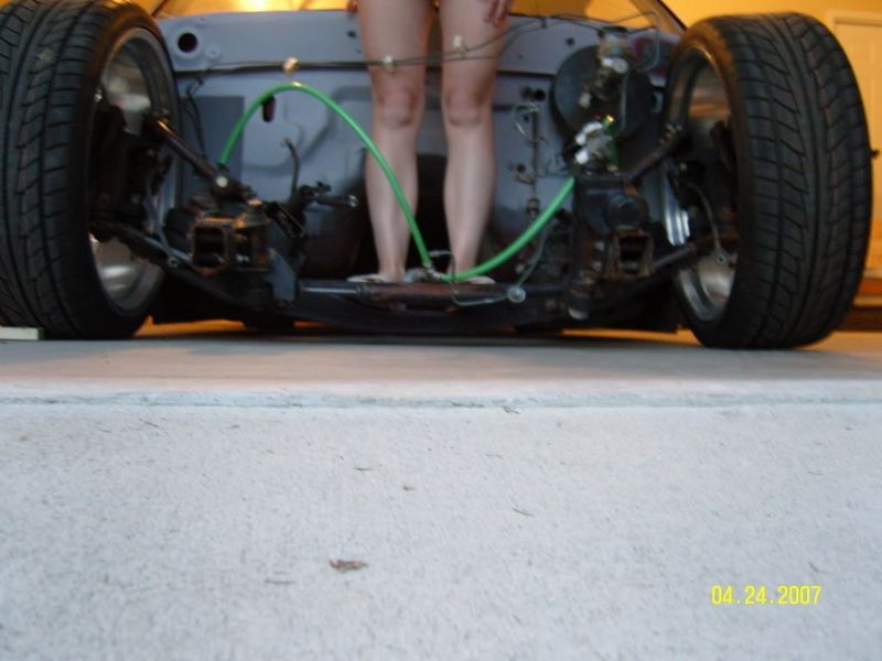

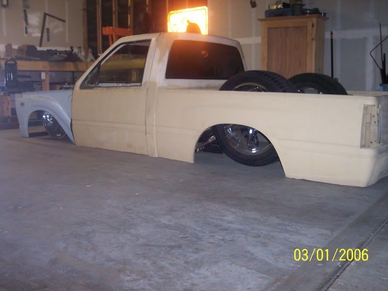

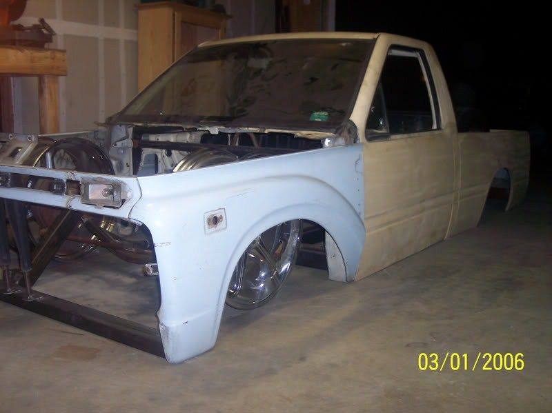

its needs more weight in the front look at my profile its laying it had a motor and trans in it when i had it
dragalac's avatar
dragalac

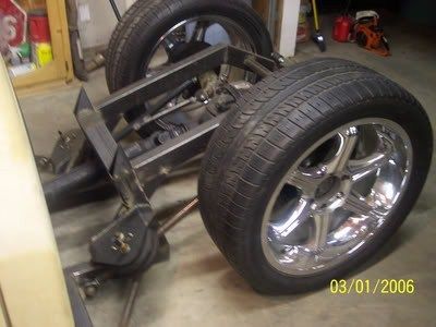

the chevy spindles will only lay 20' the isuzu 2' drop spindles lay 22 the arms need to be modified for the chevy spindle to work right or z the frame call m at 225 315 1276 i ll give you all the info you need

Whoever you have standing on the frame is not as heavy as the engine. Channel the frame threw your cab
22-zu

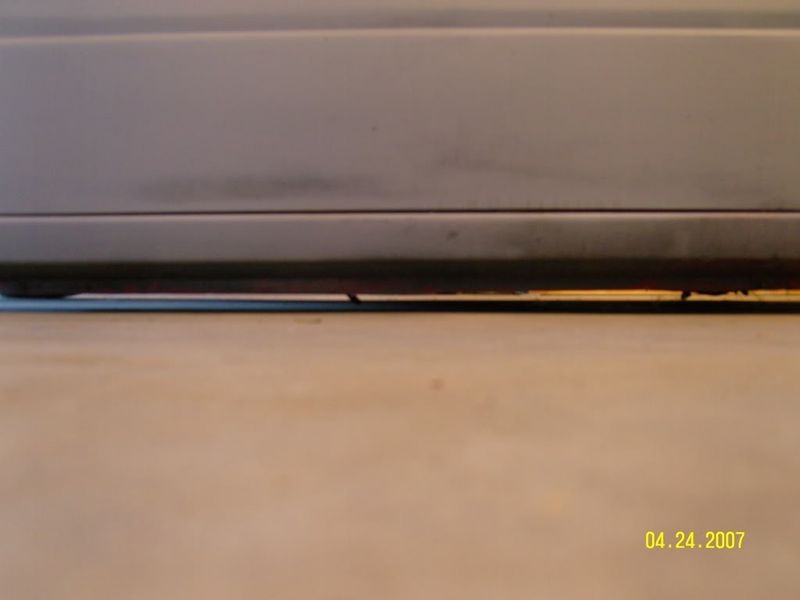

ok cool, as far as the weight goes, i didnt really think it would push those ball joints that much further, but i was wrong(happens alot). i am going to adjust my body mounts so i can cut off the pinch welds but that really has nothing to do with my main subject.

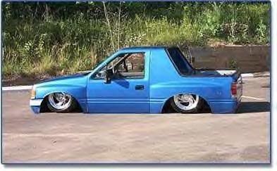

BREN0

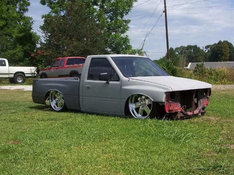

Not laid out but on 22's..
