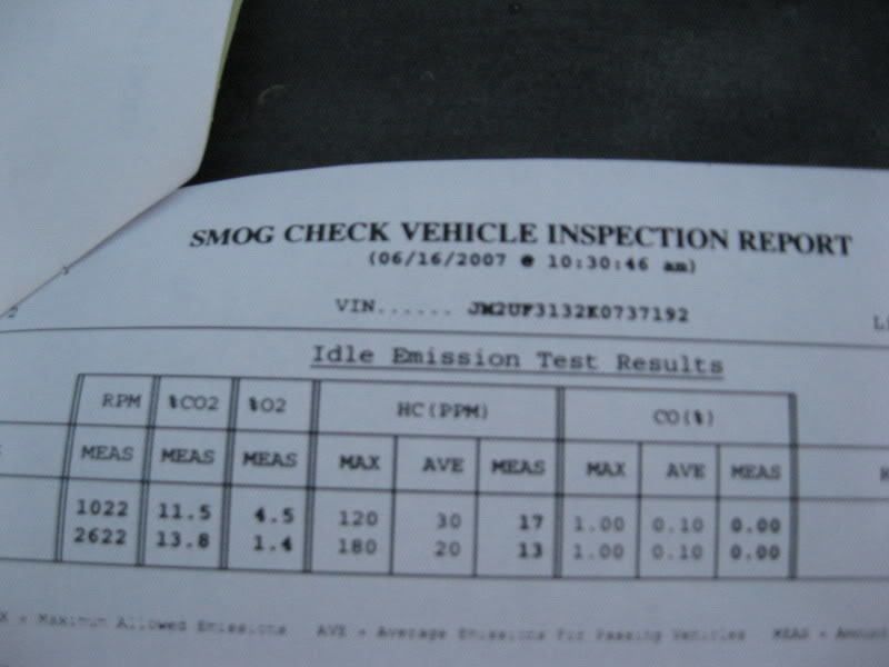

the easiest way to be certain to pass emissions is thing, gap your plugs a decent amount (not too far because then you will blow out the spark with compression) and put like a pint of airplane fuel in your tank along with about a 1/4 of gas, this will make it run awesome, i have seen an accord (my old 1980 hatchback) blowing smoke like crazy and i did those two things and it passed and nobody knew how lol. anyway good luck. OH and in california your idle can be legally 1100rpm at idle and still pass idle test so crank that biotch up to 1100 for idle, we did on my mazda.. and heres my reults...
