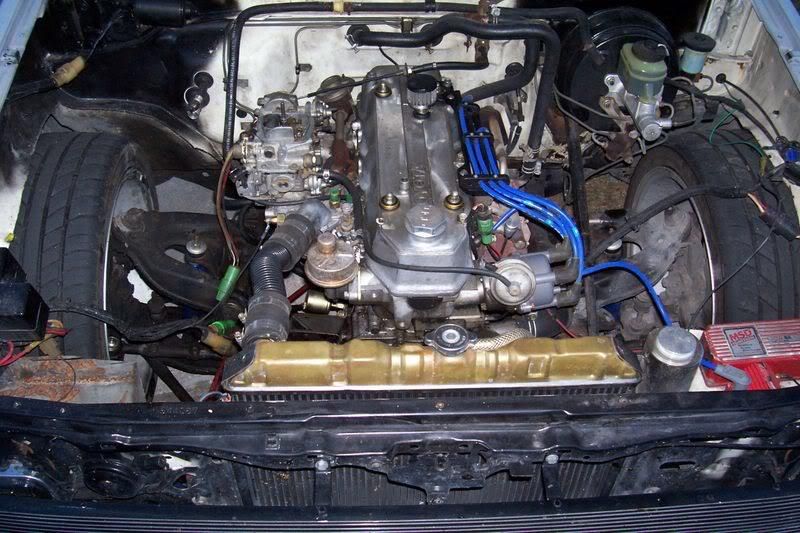

i need to clean-up my engine bay for more room. would like to clear out any unnecessary vacuum lines, filters and pump on my 22r. any photos or manual schematics would help... i need some direction!!

That is a pic of mine I pretty much unplugged wverything with the motor running and if it stalled I plugged it, There is a big vaccum junction on the pass side of the intake on the end I took it off and plugged it with a 1/2 in pipe plug IIRC
HTH

It helps if you just ditch the factory carb for a Weber. When I put a Web on mine, I got rid of alot of junk under the hood! That factory carb has so much hooked up to it.

I think he's efi
3tcrob
Thats true also if you get a header it will get rid of the EGR stuff but you will still have to put the block -plate on the intake for the egr valve, I have dual webers now
