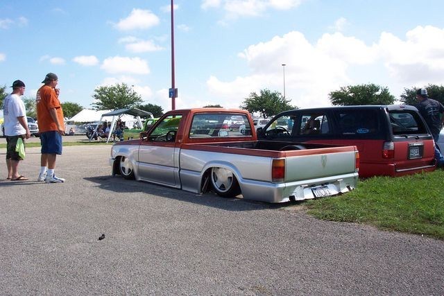

check out my profile there's a pic on there that shows it off to the side.
mine is draggable but i went through the harness and eliminated all the wires that were dicontinued so it's alot thinner than stock.it only consists of 14 wires.
i also have my battery cable running in the same fashon on the passenger side. i just hate all that stuff in my engine compartment.

here ya go.

^^^ same way i did.
