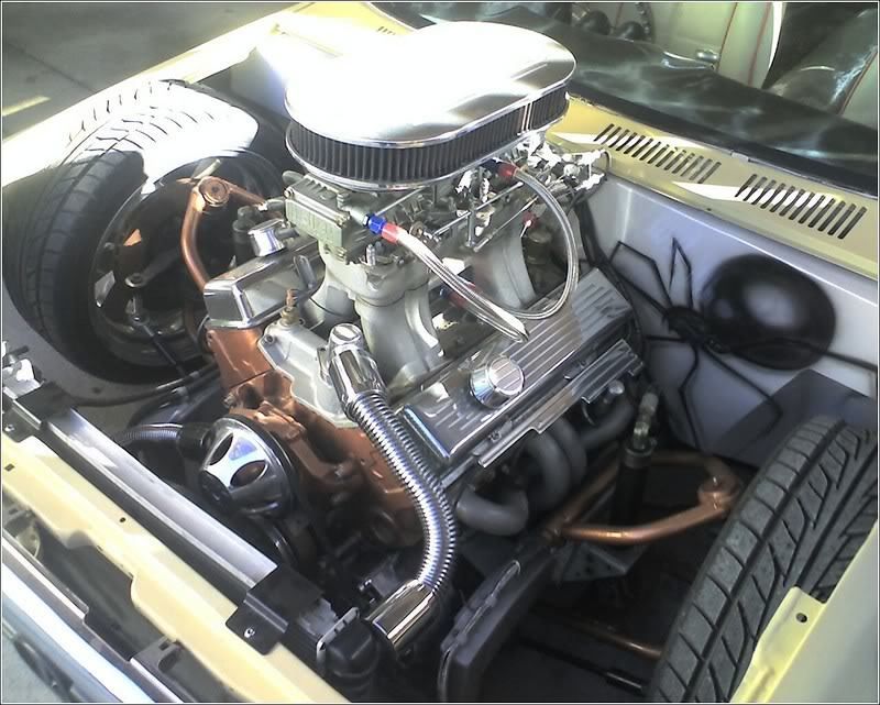

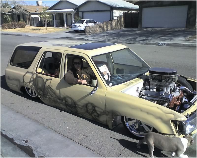

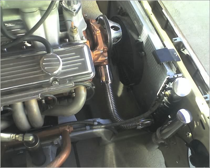

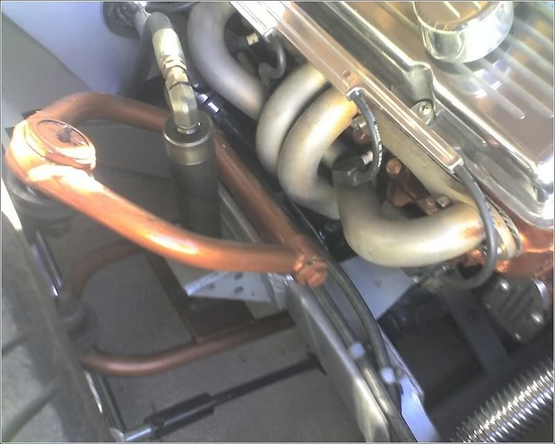

disagree, small block chevy is cake. some custom mounts and a tranny tunnel is all. everything else is run of the mill.
phatboislim
RHD SBC FTW
