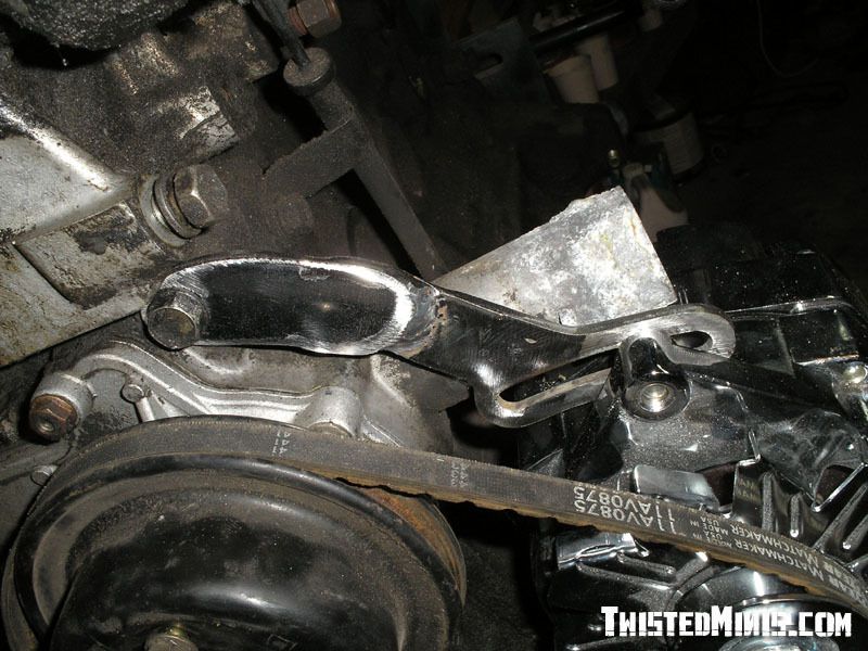

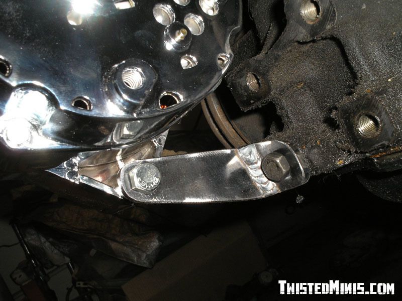

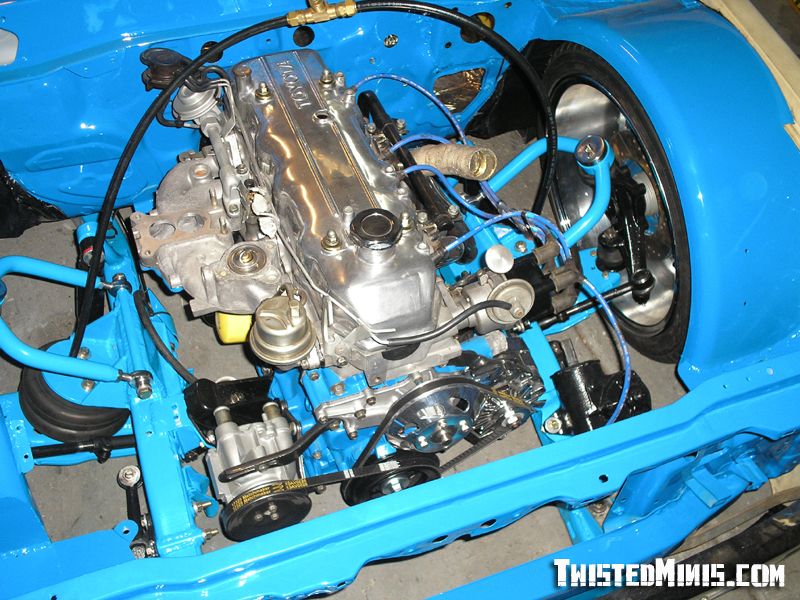

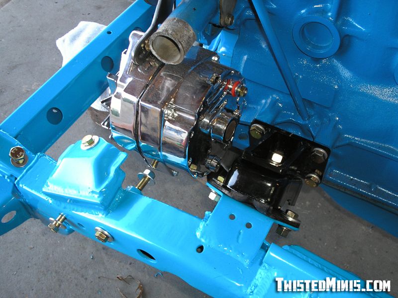

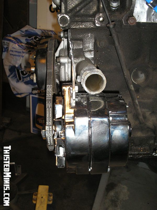

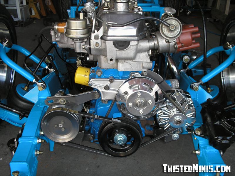

100 Amp GM 1-wire, chrome, $89 shipped. Its a little snug, but it doesnt hit anything, and it looks nice. You can see the bracketry here.
Probably an hours work. Theres soem good pictures of how to mount it. Its pretty easy.

Good pics thanks for the info.
draggin87yota's avatar
draggin87yota
nice,i wasnt sure how hard it was to make the brackets,doesnt look to hard.
