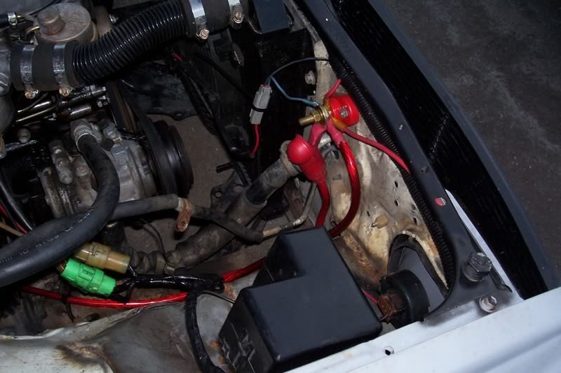

3tcrob
I used a Jump post that is insulated off a fire truck You could go to the junk yard and look on some of the GM Cars I know the Cadlillacs for sure have a little red box that is insulated and is used as a jump point I used one of them on my other car no problem and it has a cover as well
Here is my jump point now with the 2 gauge wire running throught the frame to the bed

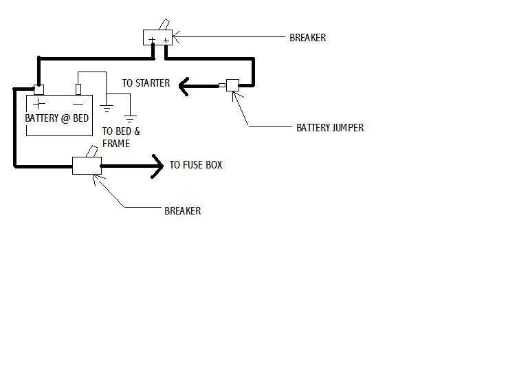

toyotaman89
2 ga car audio wire is perfectly fine, i have been in car audio for 15 years, and done this several times, 4ga will even work fine. i like the idea even better if you use a 120 amp circuit breaker in front, as well as back, use them as your distrubution blocks up front for the factory wires. the reason for the cb's is so if it grounds either in the front or rear, the cb's will pop to protect the truck before the wire starts smokin...

OKAY JUST TO MAKE SURE IM ON THE SAME PAGE AS YOU TOYOTAMAN. IS THIS HOW YOUR TALKING ABOUT TO WIRE IT? ALSO, ILL PROBABLY USE 4 GAUGE UNLESS I CAN FIND 2 AT BEST BUY. ILL PROLLY GET THE KIT SO I CAN USE THE FUSE TO PUT MY COMPRESSORS ON. WOULD 50 AMP BREAKERS BE ALRIGHT FOR THIS? OR IS IT A MUST THAT I GO TO 120? IF I USE THESE BREAKERS THEN COULD I ELIMINATE THE JUMPER? I DREW THE JUMPER IN THERE BUT DIDNT REALIZE IT UNTIL NOW. THANKS FOR ALL THE HELP.
THE PICTURE DIDNT COME OUT TO WELL, HERES THE LINK FOR THE IMAGE IF YOU NEED IT TO BE CLEARER.
hotlavaxb2089
Where would one buy these circuit breakers
holcombe347's avatar
holcombe347
i think ive seen some smaller ones like the 30 amp or something like that at advanced auto parts. but im not sure where to find the 120 amp. ones.
