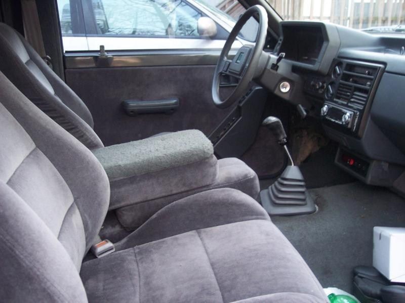

Leif, what year ext cab Mazda did your seats come out of? I noticed that the levers for the seat back are on the inside.
plantedleif's avatar
plantedleif
It does not matter what year extended cab Mazda (86-93) that you get your bucket seats from as they are all the same in that they bolt to the floor the same way. Like I said if you have a standard cab Mazda and you are wanting to put Mazda extended cab seats in it you will have no problem bolting them to the floor as the 4 extra holes needed to bolt the rails near the tunnel of the floor are there.
Not sure of what year my seats came out of but they came from an LX Mazda which has all the extras. The knob you see on the drivers seat back is for the lumbar support while the seat bottom has an adjustment for thigh support as you can see from the below pic:
As you can see there are also additional plastic pieces which help to hide the seat rails, these are on the LX seats with the thigh and lumbar supports. There are also covers which go over the rear frame rail bolts and these can be found on most extended cab seats.
