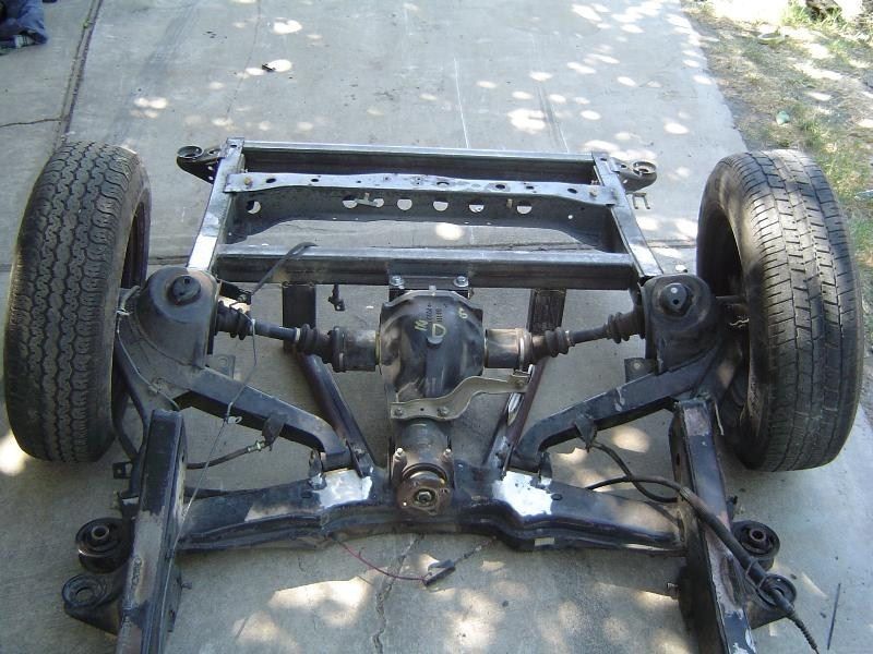

anyone have pics of a 300zx installed? the one corey picked up looks like a fucking nightmare to do anything with. just links and shit everywhere. the rx7 looks much easier to bag, and much cleaner IMO.

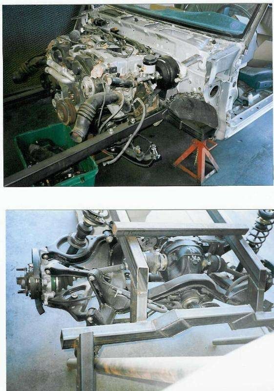

ok...here is one that looks not bad...
coreys looks nothing like that. coreys looks like this one (toffeechips)
that one just looks like a clusterfuck to me.

that 1st one is the one im talkin about, i know mine was from an 89, and it was like that. not hard at all to install, at showfest we saw a mazda with a 200zx rear, never even heard of the car til then, but its crazy narrow, and 4 lug.

ok well the toffeechips one you mentioned is the lower one. That is the one corey bought. Its ugly as sin and looks like it will be a bitch to bag. i forget what year it is.
the first one is nice and simple looking. i guess corey just picked up the wrong year.

the one i picked up was from a 1990 300zx... im waiting to see if i can trade it for an rx7 irs though... hopefully i can... otherwise thats just a mess.
