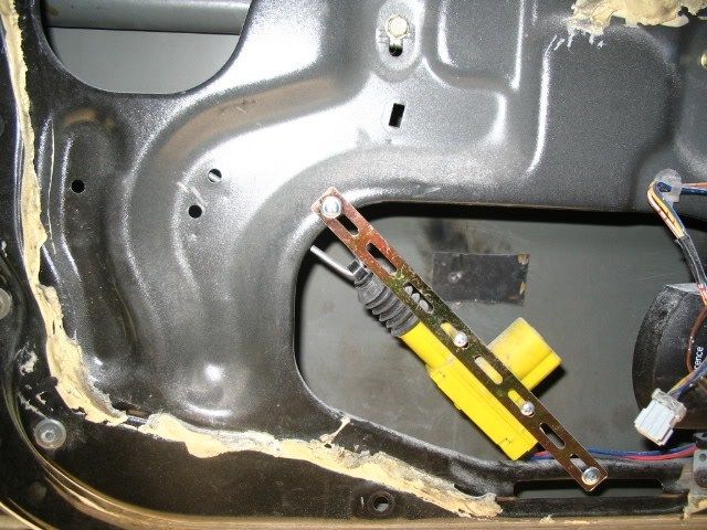

I just want to see where you guys with the 96-00 body style civics are mounting your solenoids in the doors and poppers. If anybody has any pics of this just post them up I want to just get some ideas. Thanks in advance.

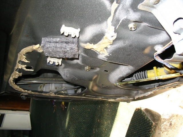

^^^ So is there a pulley or something that turns the cable up to go to the latch?
civicman
yeah if you look at the next to last photo at the back of the solenoid you can see the cable running up the backside of the door up to the latch...my civic is a 99 and there is a support bar that the cable runs behind so it doesn't interfere with the window
laiddime
on my old 97 hatch i had them mounted in the bottom corner right underneath the latch. in the pic above i used that gold bolt to mount it, it worked perfect for the 3 years i owned it and the current owner has never had a problem either.

Cool man thanks, I know exactly where you are talking about. Thanks for the pics!

Well here is how I ended up mounting mine. It's a 95 so different body style than yours but maybe it will help. Instead of using the cable that came with it I used a rod from a door lock acutator.
