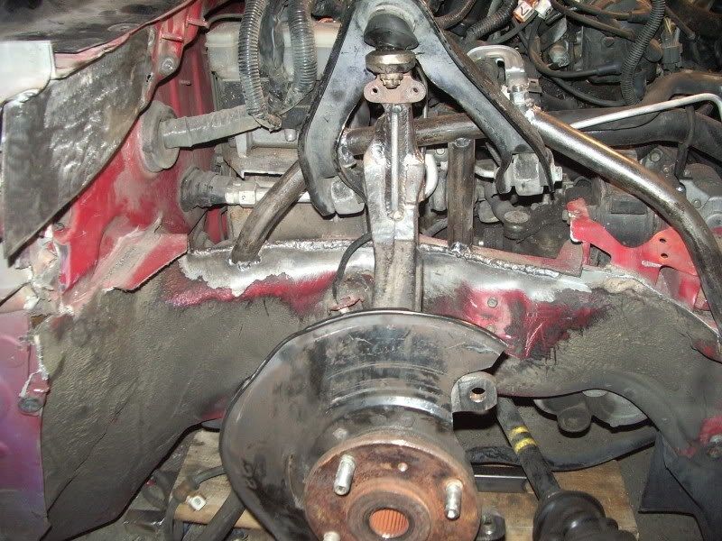

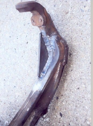

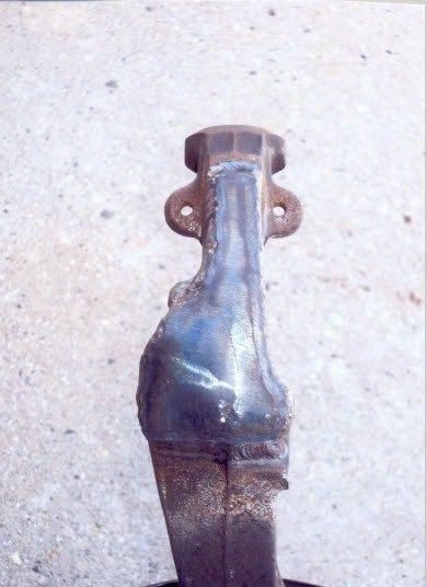

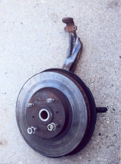

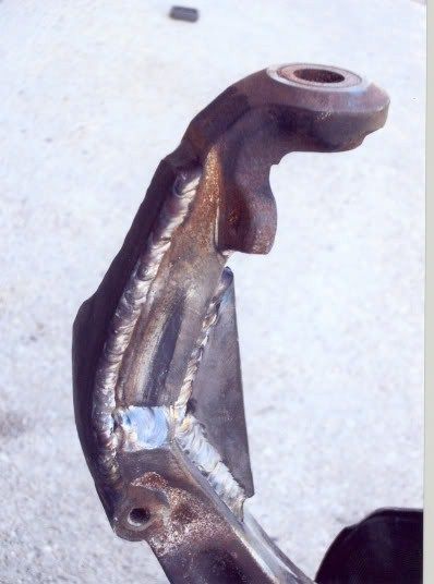

On my 95 civic from the top center of the bearing opening to the top is about 13 1/2 to 13 5/8 and the top to the bottom of the spindle is roughly 17 1/2. This is for an ex. The lower end models of my body style have a smaller wheel bearing opening.
pearldrop's avatar
pearldrop
So we have already found one spindle that is shorter than another.
I measured mine from the center of the hole, but from the edge it is about 14 1/4 inches.
Remember mine is from a 91 Civic base model.
I just tried to check the Prelude but I can't find my lug wrench with thin walls. I will get it as soon as possible.

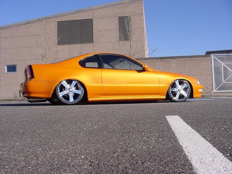

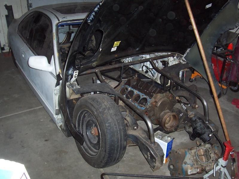

I just found this pic of the Prelude before it was painted. I just thought I would show you how low it was when it still had 16s.
I just measured the spindles in the Prelude. It was 16 inches from the center of the hub to the top of the spindle.
That is a lot longer than a Civic one. Maybe cutting won't be necessary.
I would love to see how long a spindle is in an Accord. That would be a much better swap for the Prelude, or from a Prelude to an Accord.

If anyone wants my factory spindles to mess with or cut so they don't have to take there's off let me know.
juicedwagon
i think im just gonna weld it myself. mine has to be strong but not as strong as you guy cause im not supporting the weight of the whole front end on mine(hydraulics). wish me luck. i just gotta take them off the 96 and buy new rotors and bearings

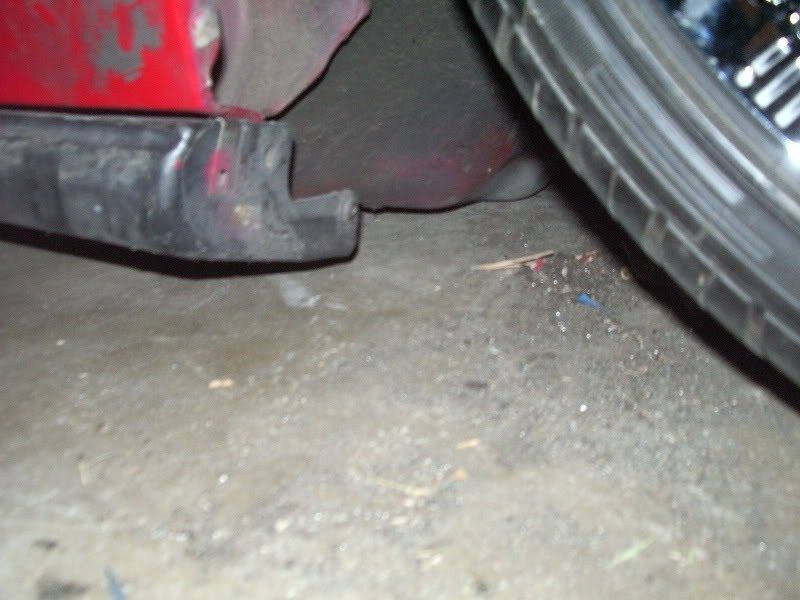

So what do all of you guys drag on your cars if you drag it? I drove mine around the parking lot today and dropped the ass and was dragging the lower control arm mounts. I don't wanna be doing that all the time and I really don't want to get drag blocks but it's starting to look that way.
drgndly
I dunna i havent had a problem with the axles yet. The avenger is based off the eclipse not the stratus so that might be why. Im prolly gonna have to raise the motor anyways or else section the oil pan and the tranny pan. I thought i was a lot closer to the oil pan but i looked at the tranny pan the otherday n noticed it had some good draggin marks in it so i gotta do somethin about before i drive it next time. I cant figure out the back of this car tho. I need to cut the control arm some for the spindle to come up through more but im afraid the ball joint is gonna start bindin by then. I took the control arm off tonight n got an inch lower n i was suprised i got that much. I might try movin it up an inch or 2 but im tryin to figure out how i can get rid of some of the cambr cuz i wanna be able to drive it low. Thanks for the heads up on the axles though. Ill have to look out for that when i get the control arms for the front.
As for what i drug before... the front cross member up front n that was about it. Im gonna fold the pinch welds over n weld some 1n half 1/4 along the bottom n drag that. Prolly put a plate of 1/2in or somethin on the rear crossmember to drag the back. I feel ya on the block thing. I am not goin through all of this work just to bolt on some big block to drag around then have everyone bitch that its only draggin blocks. Those guys have no idea of what guys like us go through to get these cars low. Then they just laugh cuz we cant be called "minitruckers"
