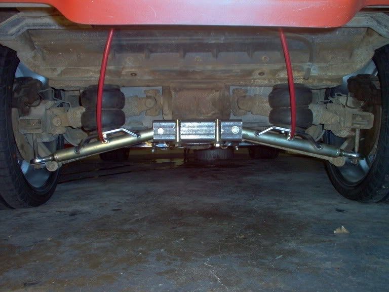

Not that it's NHRA legal, what cons can you guys find with putting power to my set up---any input appreciated.

is the only thing holding the bar on is that tiny pin at the end that looks like it was for a sway bar? if so that is death.

That "tiny pin" is the factory bolt that held the load of the original leaves.
