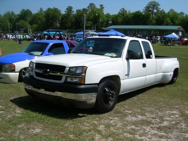

shaggy_tacoman
im not completely sure he has a write up at his house where they guy layed frame with out zing the frame i trust him he has bagged a good bit of trucks including hit dd. dont get me wrong i trust everything that u guys are telling me and the ones that i looked at the builds was a sweet job but the only reason i made the post is because i was told that the truck didnt have to be zed the i heard on custom tacos it did so i post this then i was talking to my boy that going to be doing it he said u dont have to just change a few things. by the way he is my buddy truck the first truck that he ever took under the knife.
shaggy_tacoman
the truck has air still in the front so its not all the way down plus a tranny crossmember is in the way to lay full frame
yodaforce's avatar
yodaforce
I guess you could lay frame like that, but it may just be the back of it, and you could consider the front crossmember a "frame", so sure, I guess you could.
