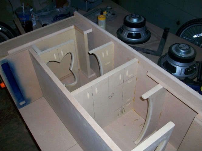

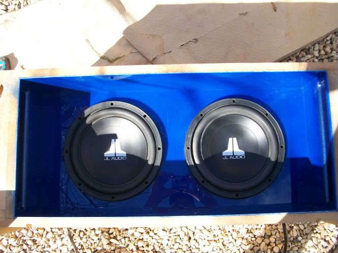

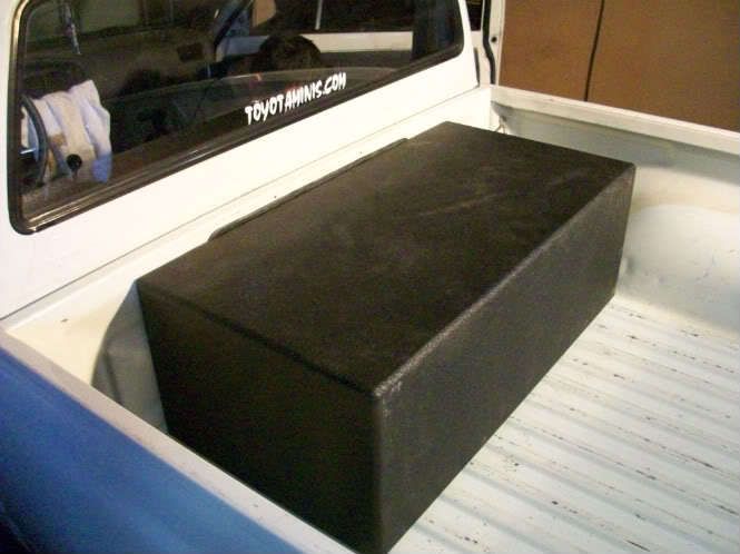

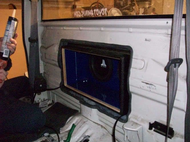

My bedbox is built out 3/4" MDF with a sleeve into the cab and sprayed with Line-X about 1/8" thick. Here are some pics....
here is the link to whole system build...
