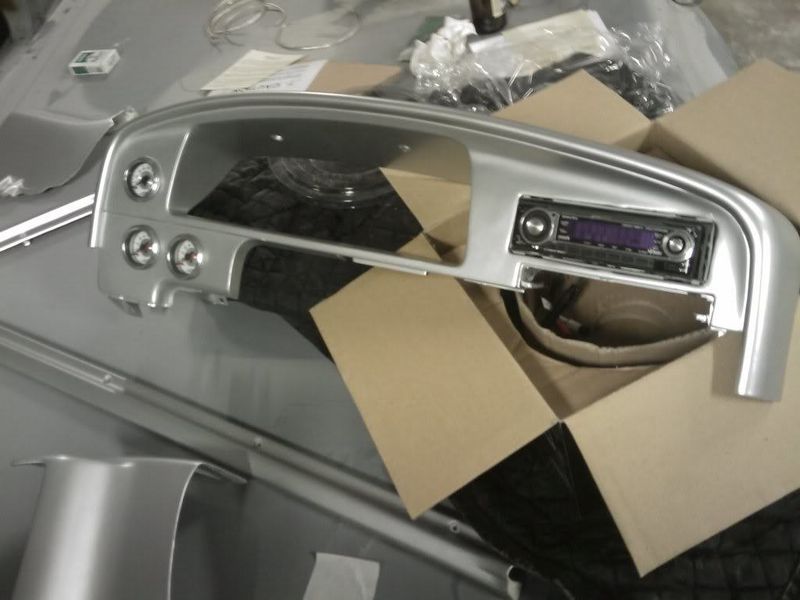

Can you please tell me how you smoothed out the air vents. I have been wanting to do this on mine and I bought a spare cluster cover and a sheet of abs plastic but trying to figure out where to go from there. Thanks
collins94's avatar
collins94
you cut out the vents and take the smooth plastic you bought and cut out a filler then plastic weld it ( or fasten it in another method) and smooth over with urethane filler then a smaller layer of finish putty to smooth it out

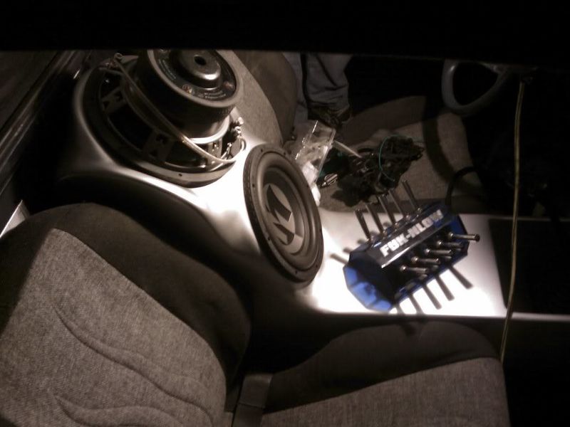

diggin the console. 10's or 8's?

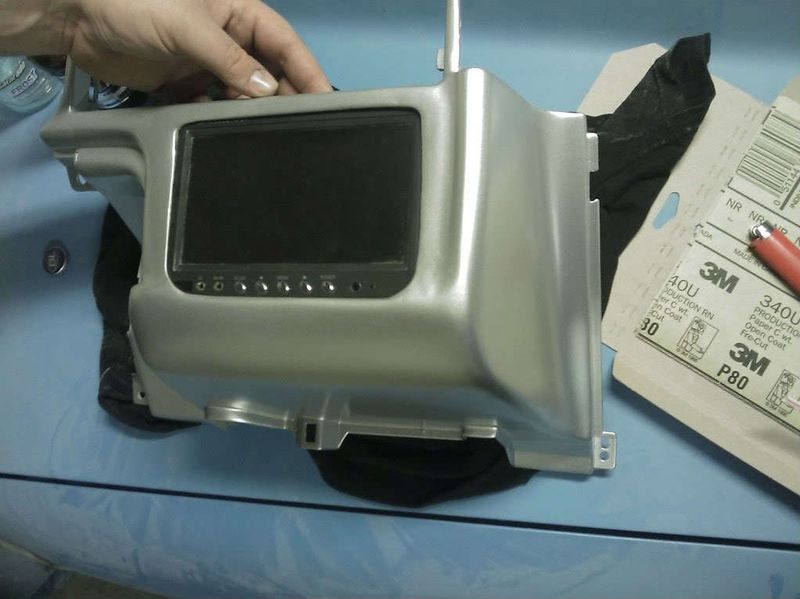

Nice work man, did you use a plastic welder? Looks really smooth!
