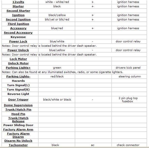

I'm in the process of wiring up solenoids for the doors. Anyone know which wire on ignition harness is "switch ignition power"?? 92 yota. thanks.

at the risk of sounding like myself, get a test light and poke the fat ones under the column whilst turning the key on and off.
sorry for that, but really is the best way, don't rely on someone else vague memories of wire colors for something like that. just go poke the big ones.
toyotaman89
Thats better

stll2hi's avatar
stll2hi
That's awesome...thanks!!
toyotaman89
ok, that one looks MUCH better
stll2hi's avatar
stll2hi
Perfect. I'll be copy all of that. Thanks.
