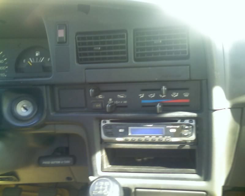

OK i got a 93 2wd im tryin to get the cd player out but i cant figure out how the dash comes apart

take off the piece under the ash tray = two pushin clips(push in center, pull out clip).
pull off key surround.
take off the piece under the column = about 5 or 6 screws, and one 10mm bolt.
take off the piece around/attached to the glove box = 4 or 5 screws and one 10mm bolt.
remove slider buttons(pull off).
remove ac switch(very carefully lol) it pulls straight out.
remove heater control face plate(pops out, slide cup holder out to get fingers in)
remove two or three screws from center piece(dont forget the one behind heater control panel) and remove center piece.
remove the four screws holding radio/pocket assembly.

ok thanks will i be able to get to the dash speakers like that to?
kdcgrohl's avatar
kdcgrohl
when you pull off the left and right panel, the driver side is attached to the dash structure, and the passenger is attached to the back of the glove box piece on the right.
