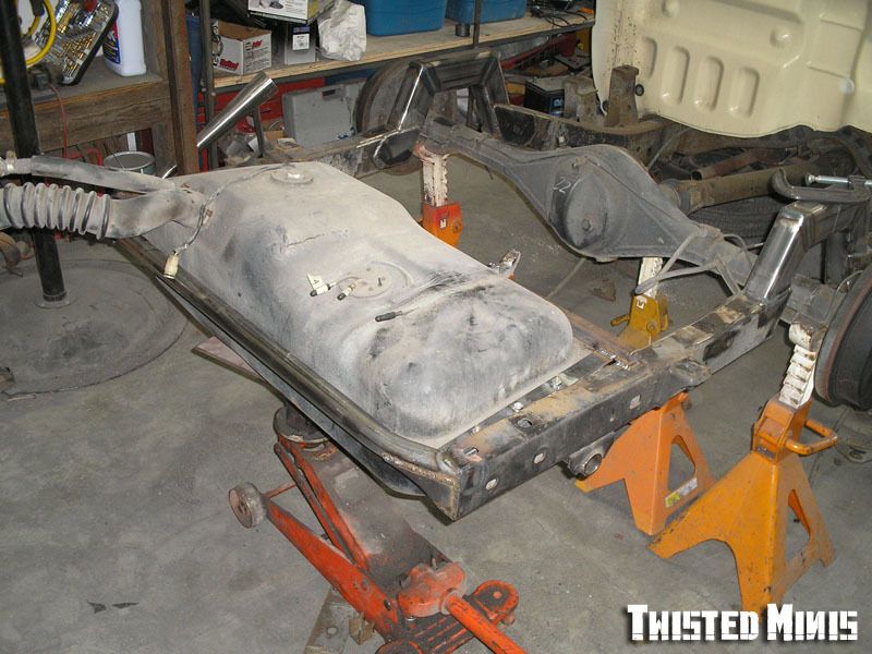

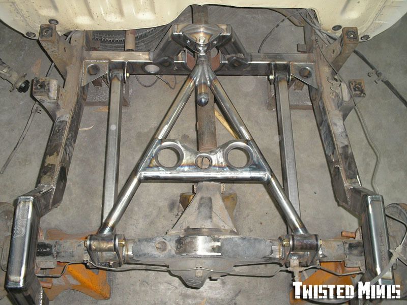

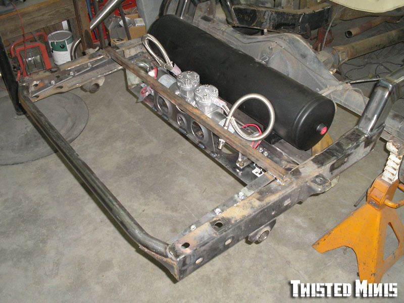

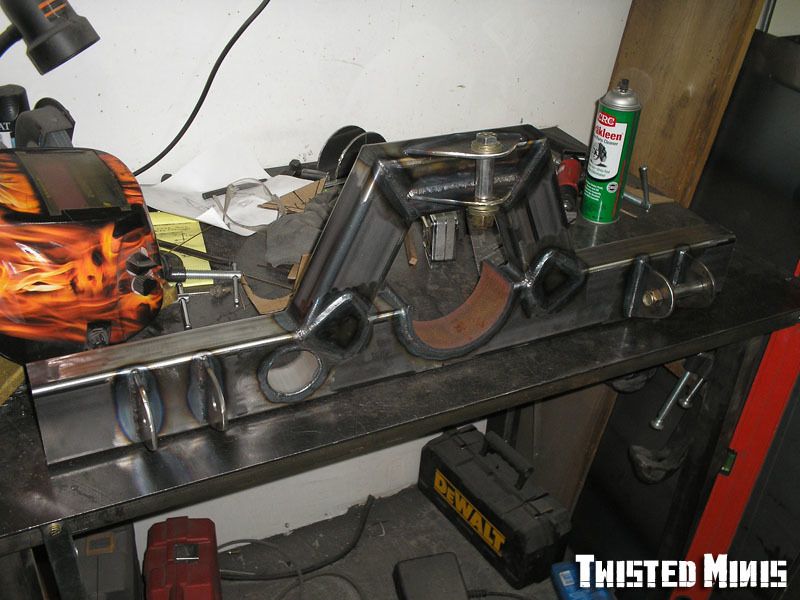

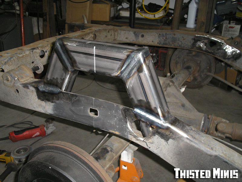

Here's the newest project, in for a full bag job.

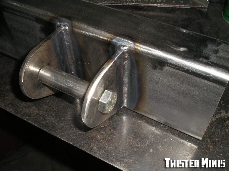

I started the front most cross member. Not much to it yet, but it's only about 1/3 of the way done. The rest of my vision for this should unfold tomorrow.
caz
dam you work clean

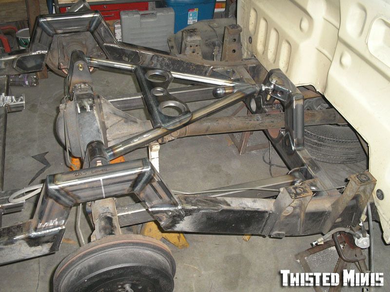

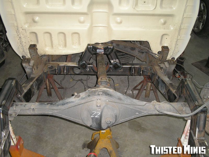

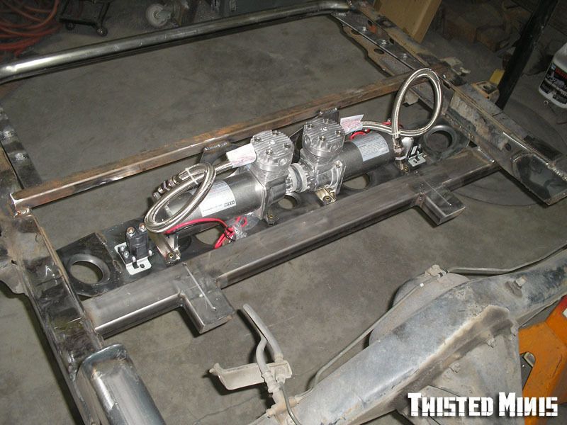

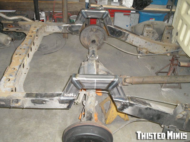

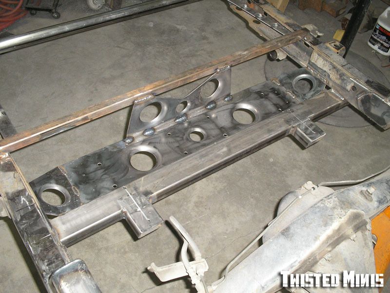

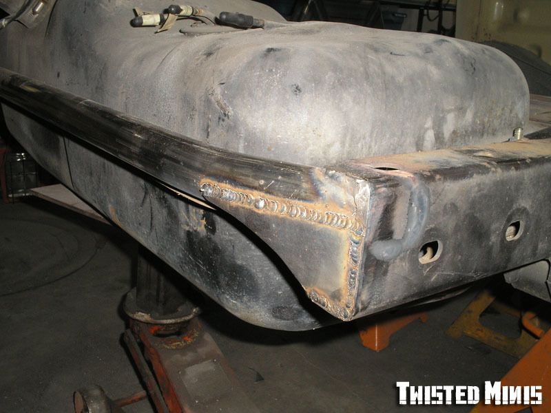

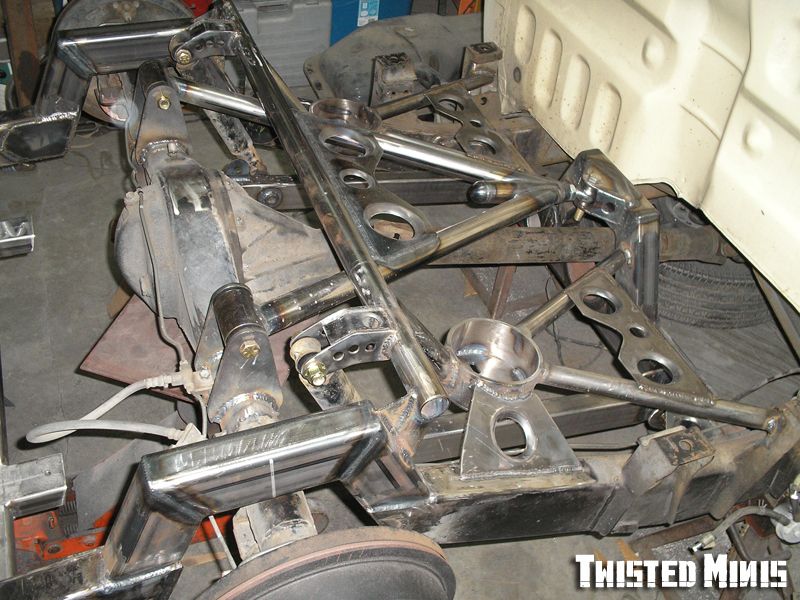

Very. Busy enough to hire a kid part time. I forgot to take pictures of what he did today, basically just removed all the extra tabs, and built a crossmember out back.

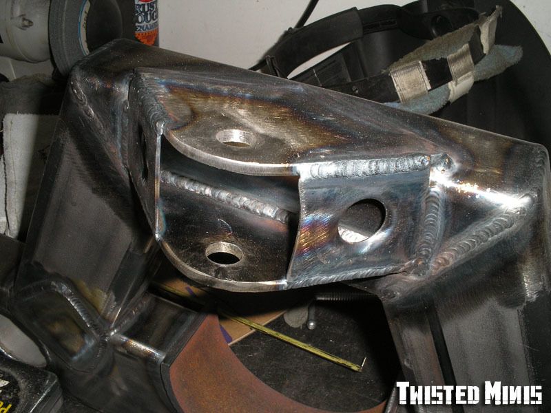

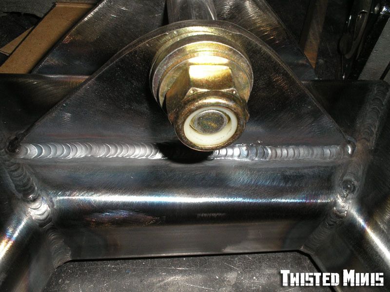

I got the cross member pretty much wrapped up tonight.

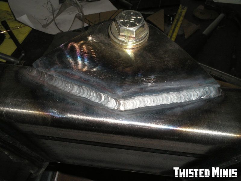

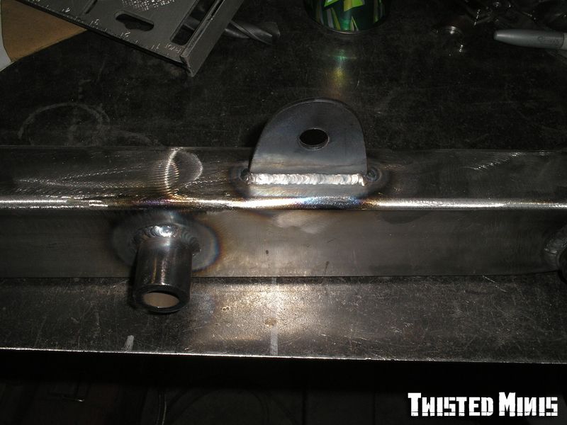

The ones on the bottom always look the best right?

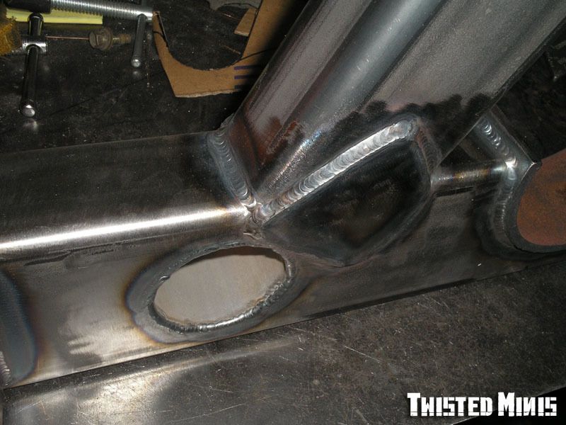

macdave06

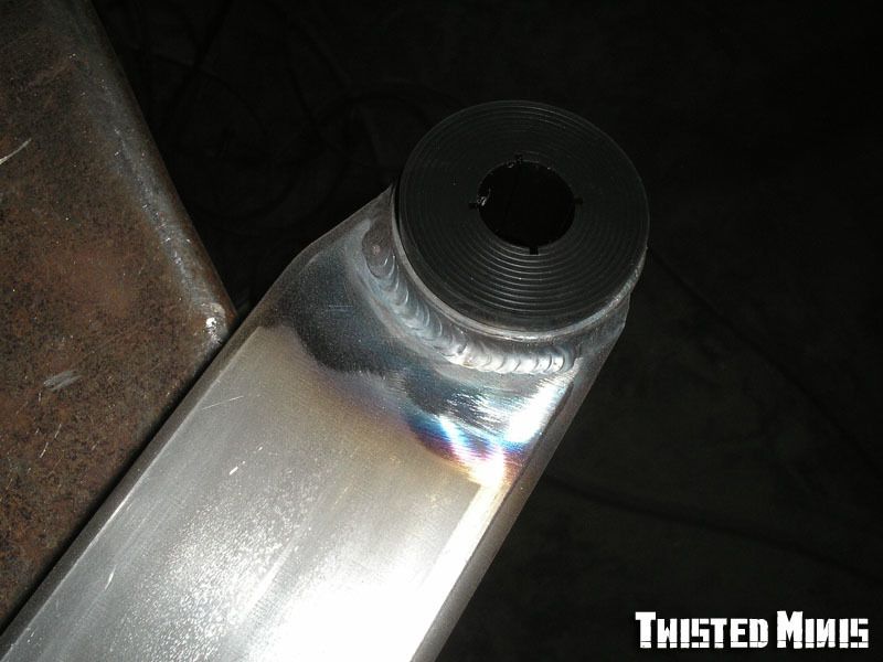

All TIG'd?
twisted minis's avatar
twisted minis
So far yes. My MIG is out being serviced.
macdave06
Sucks. You say it like TIG's a bad thing haha. Of course I guess it is if you value your free time.
