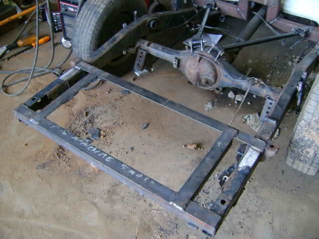

here's what i did, really simple, quick, and easy. Plus im a tight wad and just had some angle iron laying around so i made this lol.
Then i just spliced the wires for the harness and extended them along the frame rail back. I was told that i needed to extend the hard gas line with more hard gas line due to fuel pressure, I wasn't 100% on that but ended up using AN fittings and steel braided lines to extend the hard gas lines.
And for those of you wondering, yes the truck is now notched and lays out, never realized how weird it looked like this until now hahahaha.

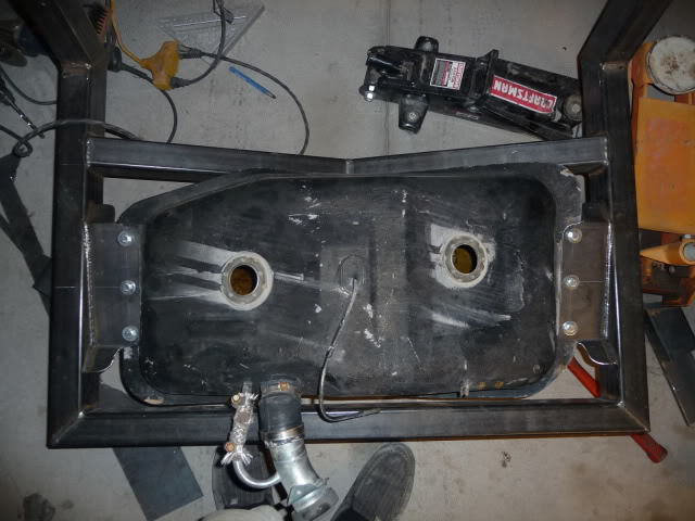

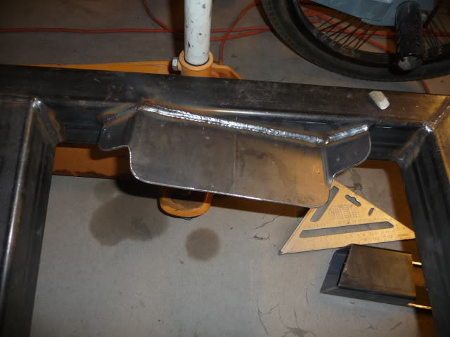

here is how i did a stock 86 tank in my 73's frame, which is a bit narrower then the later years frames.
