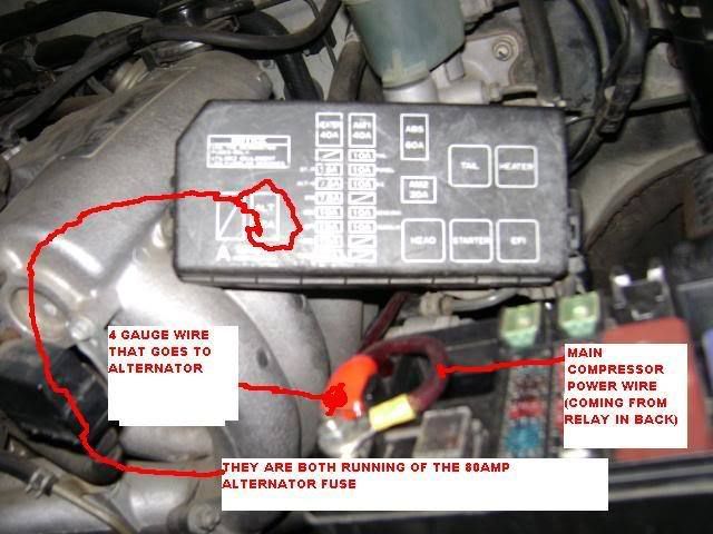

Very interesting, I'll look into the isolation kit. I agree that the isolation would work, however I really have no money right now and also, I think its odd that before i had the optima and before i got my compressors I was running 3, 380c viair compressors and my system, all on my stock alternator before i even upgraded to the 160 amp, (and that is since i bought the truck until a month ago when i decided to upgrade the alt) all that was running off of a interstate battery. Just a few days ago I had the optima recharged and i didnt use it for a few days then i hooked it up to my truck (this is after the battery wire relocated to bed and big three upgrade) and it was dead as a doorknob, my truck didnt even crank over. Yesterday I relooked everything over, all the wire i ran to the back, and there is no drainage anywhere HOWEVER I did notice something that MIGHT be the problem. Ok currently my compressors are ran like this, theres two viair 480c comps both the positive wires of the comps go to a 80amp relay, and from the relay there is a 3 or 4 gauge (main compressor power wire) that runs all the way back up to the front to my fusebox and bolts to the same 80amp fuse that my alternator runs off of, I am wondering if the compressors are just taking the energy out of the alternators power when in reality the main compressor power wire coming from the Relay should be ran to the positive battery post with an 80amp fuse inline with it?

and heres a little picture i took of the main compressor power wire coming off the 80amp fuse in the fusebox along with the 4g wire going to the alternator

alright, i figure out the problem, i just needed to run the truck a little and get the alt charging the battery, it runs fine now.
