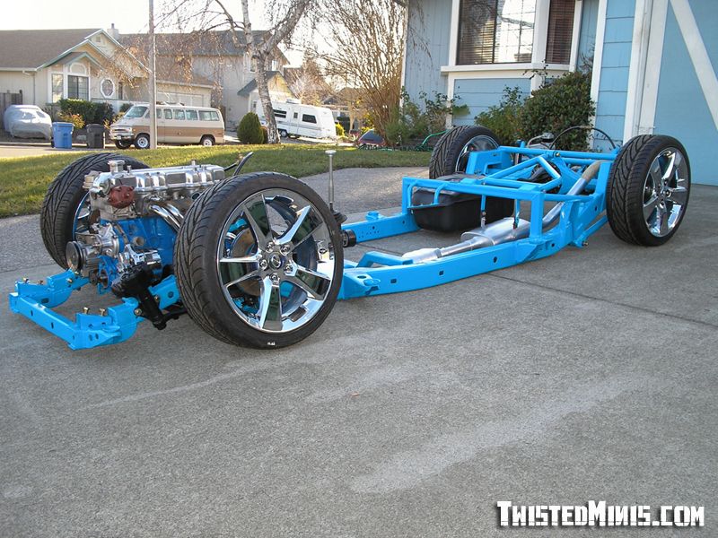

twisted minis's avatar
twisted minis
Or, my transmember.
