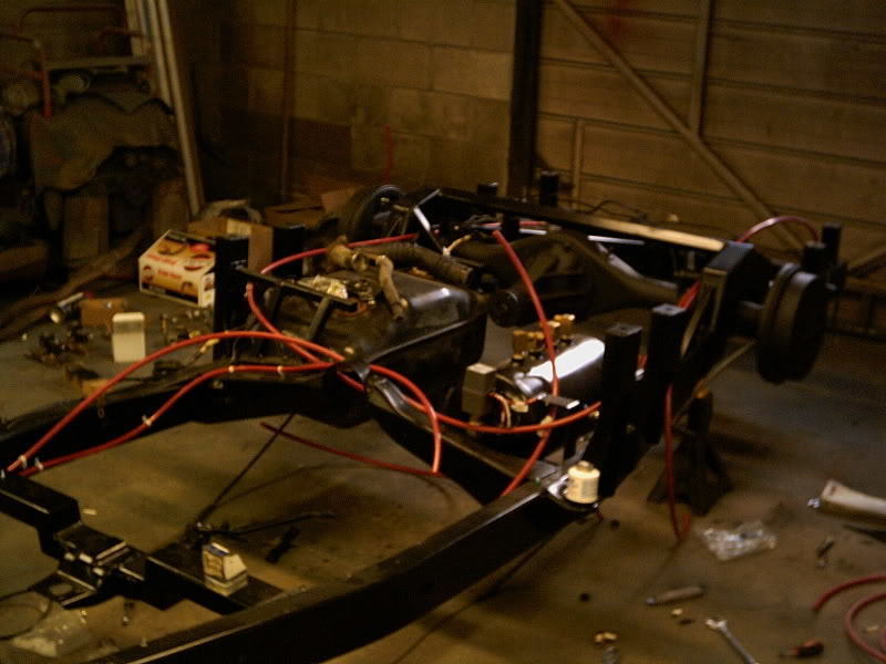

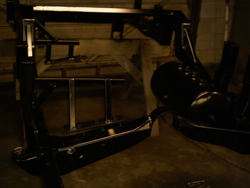

I made new cross members to support it. Very easy. I just laid the truck out and put some 1.5" tube under the tank and made mounts.
cnudrln
im doing the same thing as seth done. only i used 1" instead of 1.5" tube
m_i_zombie
looking at your profile you haven't done your notch yet correct?? make your new mounts when you get your notch in. it will be less work in the long run.
I used some 1/4 plate and 3/16 wall 1" square tubing. Just make sure it has plenty of support. Even though the tanks hold roughly 14gal, its the momentum of the fuel that will bend or break your braces.
twisted minis's avatar
twisted minis
The other thing you can do is flip the flange onto the top side of the cross member and put some spacers in it. Then build a new rear cross member, or raise the stock one.
