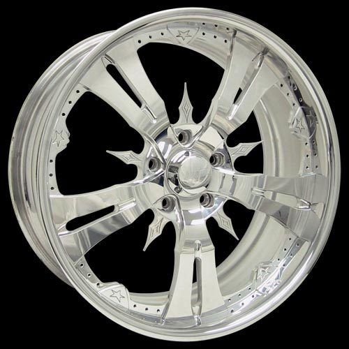

the only thing is they are 8in wide...? im trying to have a problem free install...lol so im relying on you guys here lol

I can fit 8.5in wide wheels on my bodydropped yota. You'll be fine man, and if im correct the bolt pattern is 5x4.5 also measured as 5x114.3 make sure thats your pattern

I have a 93 did you see that link I posted? technicallythose tsws should bolt right up. I just don't want to be out all that cash if they don't fit -thanks

if your bolt pattern is 5x120 then yes they will bolt up. You will have no problem tucking those rims, you may have to do a little cutting on your rear bed wheel wells and some up front so they dont hit, but yes they will tuck and you wont have problems with their width.

thats the part i get confused on, I have 5lug 4.75 wich is..120 i think lol

5x4.75 is the same as 5x120 yes, you will have no problems tucking that rim. I was going to get the same ones for my yota, that price is a steal i would hop on it quick

NO!!...u have a 5x114.3 on your toyota truck unless for some reason u changed the hubs..

Yes toyotas use 5x114.3mm or 5x4.5" bolt circle. The thing you have to watch on rice rims is that they are ment to be on fwd cars with out a dust cap on the front wheel and alot of time the center bore is wrong. I just ordered a set of these for my truck.

man this is such a nightmare....lol. somebody find me some wheels!! haha. Those firts wheels i posted prolly won't work because of the hub.
