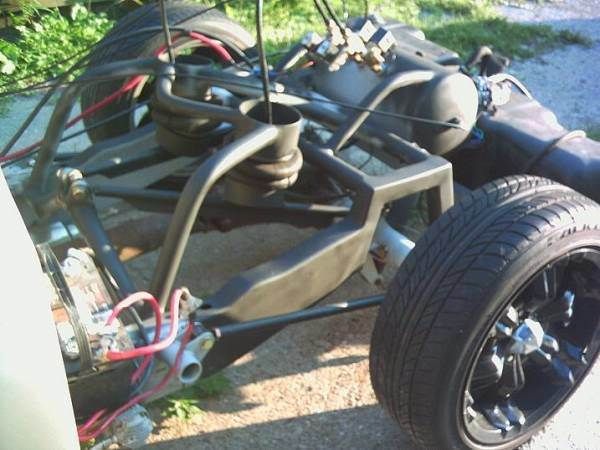

as far as the rear goes i'm planning on something similar to the pic i have below, but its going to be alot cleaner. im gonna be running hardlines instead of rubber, and of course it will all be 2"x3" instead of goin to 2"x2" off the factory frame like in the picture
