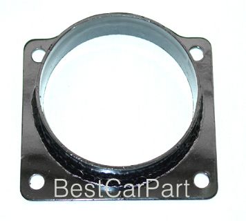

i was at auto zone saturday, they sell maf adapters now...
