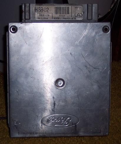

pull the motor, computer, distributor and VAM pigtail
you can use computer controlled boost, but why would you want to
you will have to repin the ranger harness for the computer you get out of your donor car

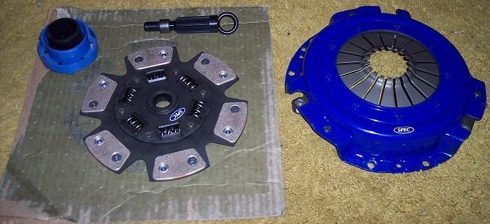

and get a good clutch
i got a spec clutch $380

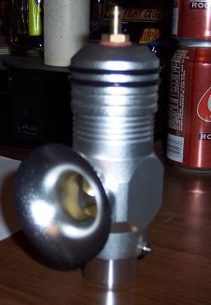

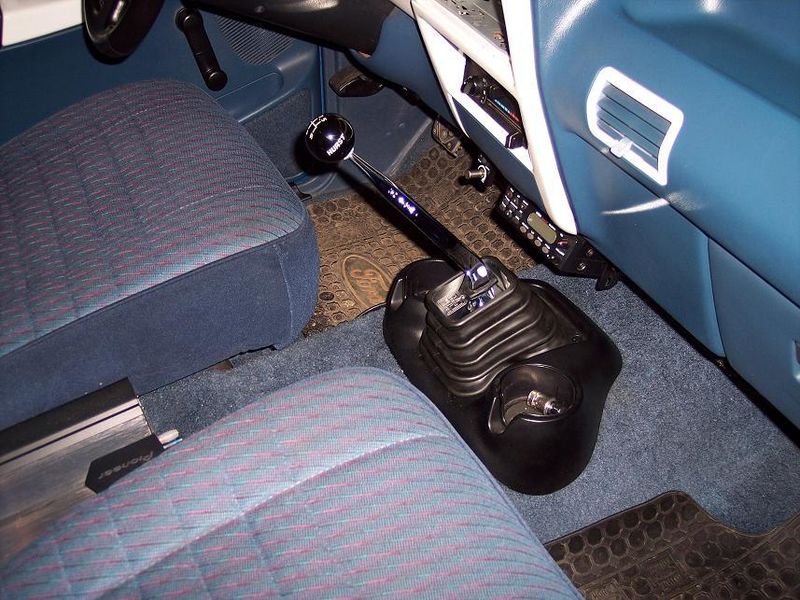

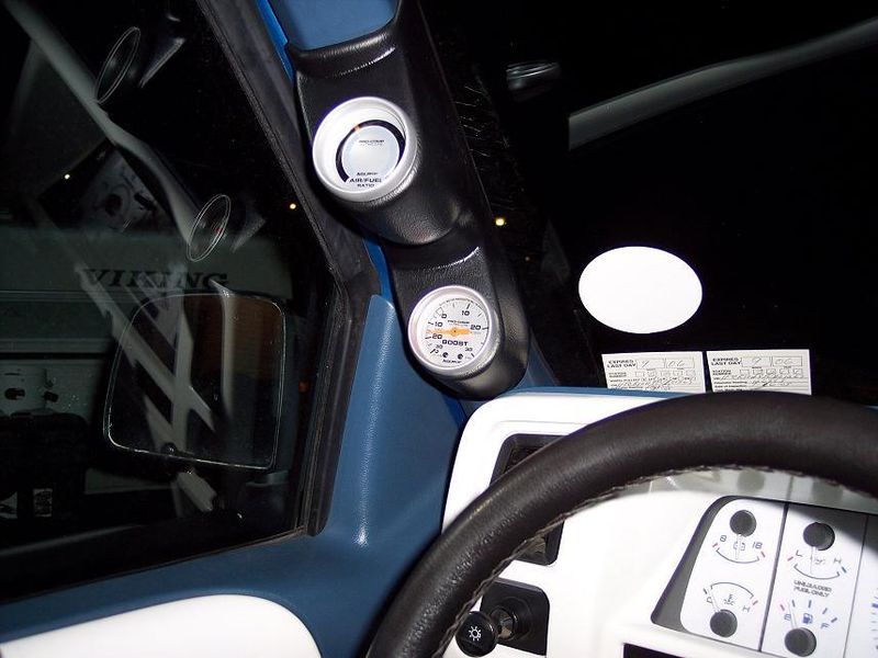

here are a few pics of other things i got
