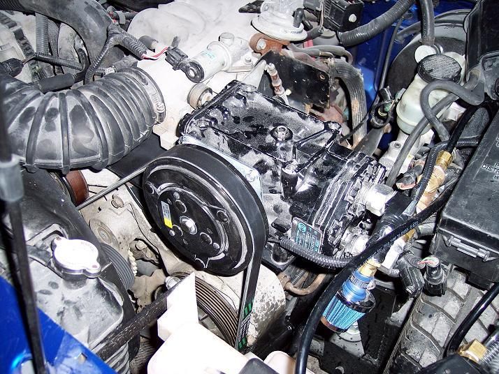

Is anyone running a york compressor on a 3.0 ranger engine, if so please please let me know and pics would be great, my truck is a 99 and i am not sure if one will fit in place of the a/c cause of the throttle linkage..
draginassranger
that is my install....there are a few more pictures on my page under the "bodywork part 3" section....mine is a 96 so i don't know how much different yours is from mine

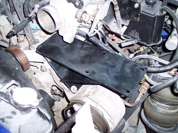

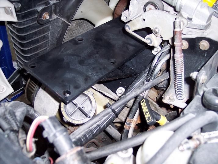

draginassranger
only down fall is that i need to take the whole bracket off just to put powersteering fluid in the truck....i haven't quite figured out how to solve that problem yet.

bodydropped85's avatar
bodydropped85
from the looks of that, u could pop the cap off, mite have to break the dipstick off, but mark the full level on the tube and use a big funnel

Hey thanks for the pics of the install looks great... i did not know that you could mount the compressors on their side like that....
draginassranger
haha i tried that....the bracket comes right across the top of the cap...just hope my power steering fluid level never goes down
