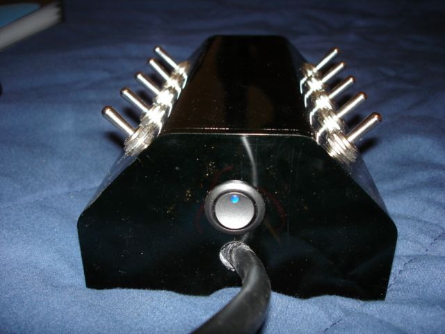

Or you can do that pimp power switch on the switch box itself like ricky at Why Not Fab.
Thats a realy good idea, I was going to do that if I ever ran a switch box, I just ran mine to my factory door lock switch, hide your switches
daweezi
that power switch idea is bad ass
