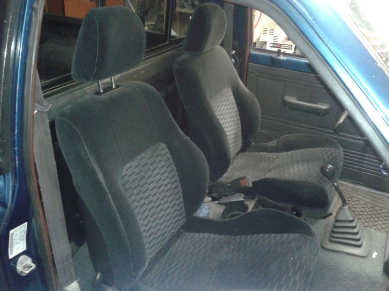

I half assed installed them for now. Best way is to cut off the mounting tabs, reposition, then re-weld since they are just welded on to begin with. The mounts are at most 2 " off. For now I used some metal, bolted them to the floor, then bolted the seats to the metal lol.
Here they are installed, they are nice and comfy, plus they are heated for the winter, hi and low settings, got to wire those in and figure out where to put the switches.

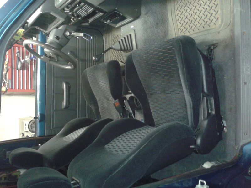

2nd pic is when you are preparing for shuttle launch.
