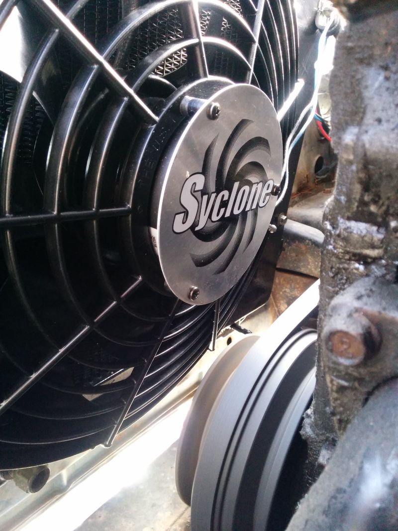

I have also read about the Taurus fan, I am currently using the fan from an Acura NSX (expensive and hard to find) but I got it next to free - it's soooo quiet I sometimes wonder if it's working...
It blows so much air though.

What I wonder is how much clearance you have - I deleted the fan pulley entirely to gain space - hacked up the mount on the motor and got a shorter belt.

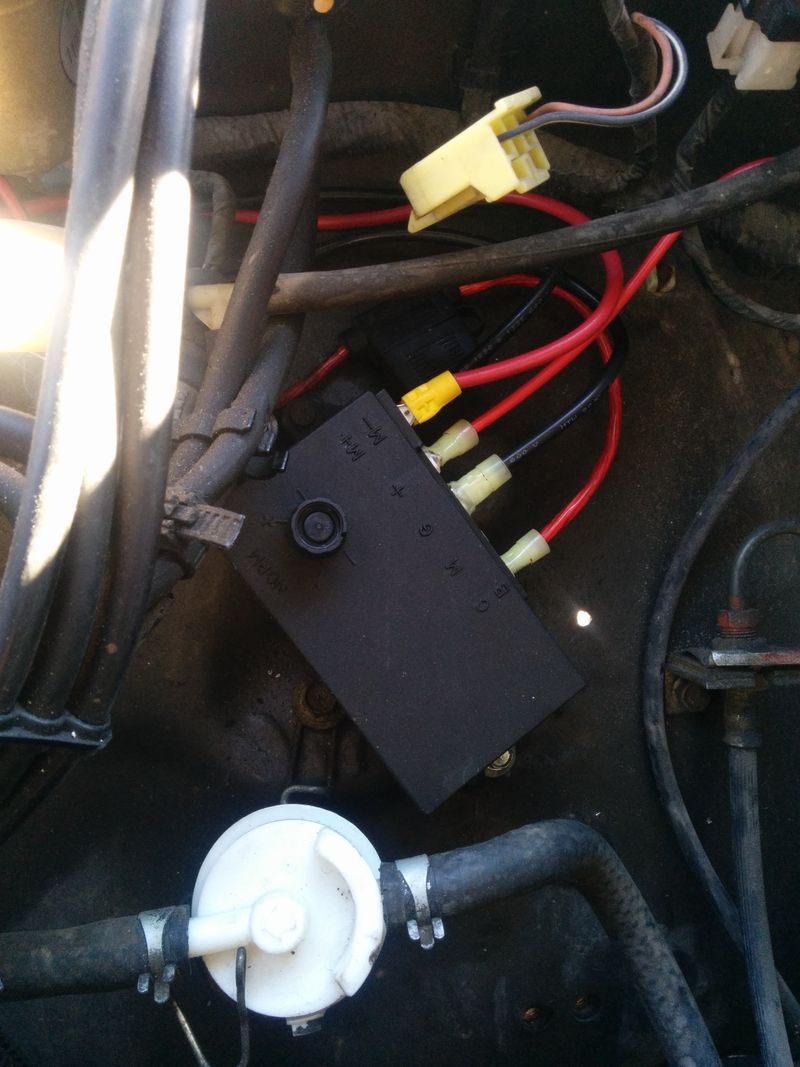

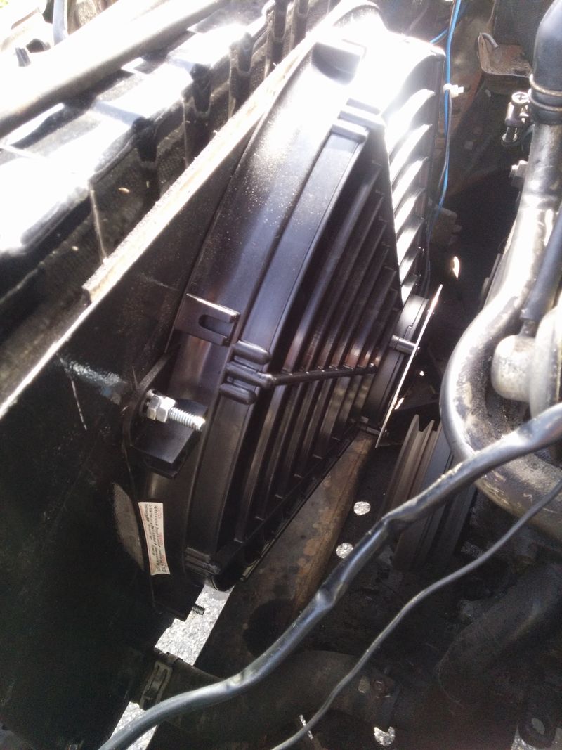

This is my setup I have a 2 row radiator ment for a automatic b2200
Z
z2000
Hit submit too soon! It is a flexalite fan with a flexalite relay/ temp sensor. I also wired up a manual override switch for a piece of mind!
