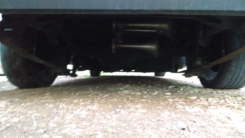

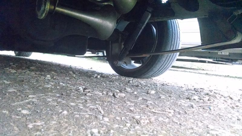

Post pics of the setup

mymmeryloss's avatar
mymmeryloss
Those pictures dont show much
