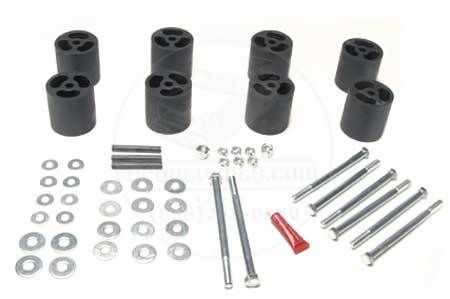

That's a tough one, your truck is rare for the after market. I think you may have to look at doing something custom. 3" with some bigger tires should do it. 3" is a common size for body lifts, maybe you could buy a generic body lift and install it your self.
If you are unfamiliar with body lifts, generally you just unbolt the body, lift it up using a jack and install the body lift spacers before bolting the body back to the frame.

The body lift is an option but you may run into some snags...
Lifting the body off the frame will stretch out your brake lines so you may have to get some longer ones, fuel filler tube extension may be needed, the shifter hole may need to be cut wider, radiator lowering brackets must be made, clutch line may need to be replaced with longer ones, steering shaft may need to be extended with spacers, plus whatever else may come at you during the process.
It is possible but requires a lot of adjusting to components that attach from frame to body etc.
