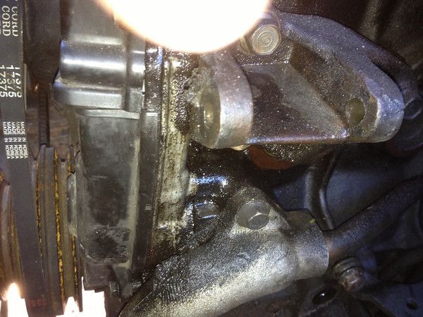

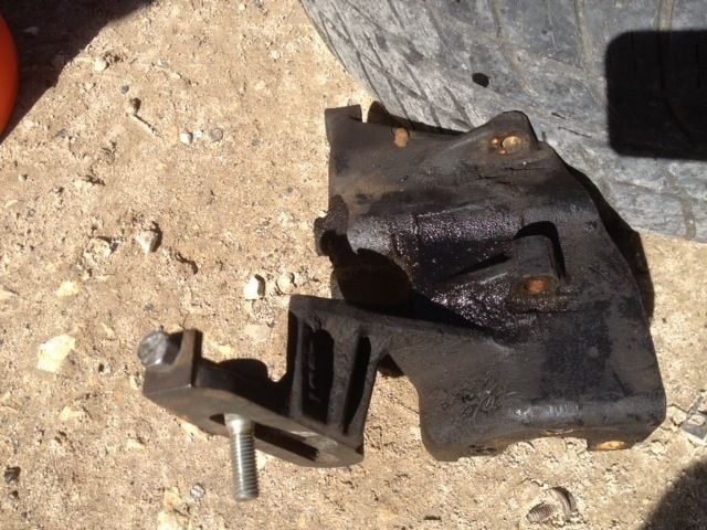

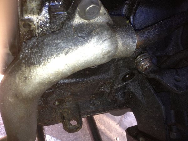

91_2600i
Here is the setup from an 86 B2000.
Mount location on the block - yours should look the same.
Here is the mount. The power steering pump sits underneath. The mount on the top is the bottom mount for the AC compressor.
And here is the upper mount for the AC compressor.

nevermind I suppose. Thank you. I work grave yard so my night is actually most peoples morning and vice versa, it makes my days really confusing. I actually just got on to post some photos and saw that 91 2600i got it for me. lol
