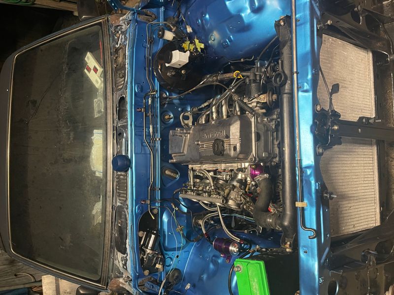

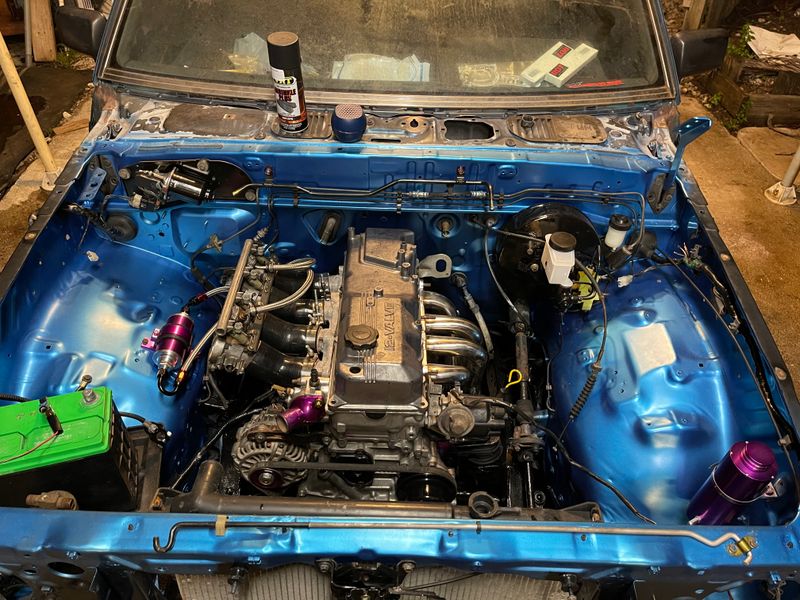

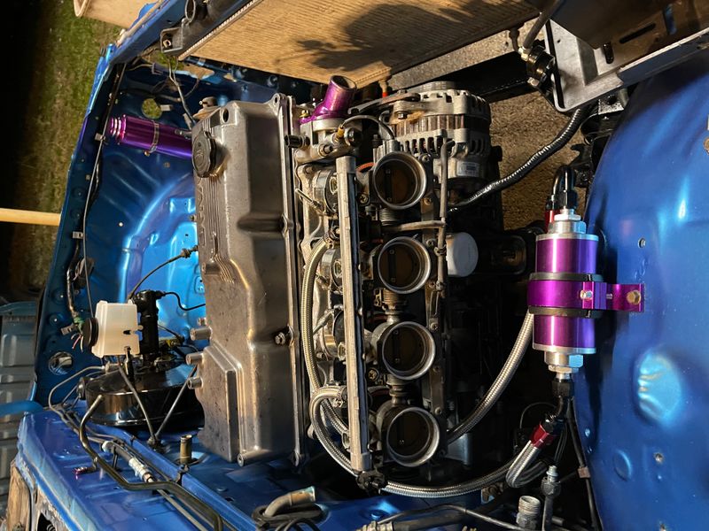

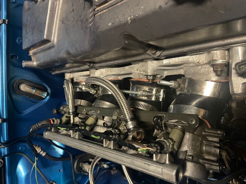

I built my own. I got mazda b2600i with mitsubishi 3000gt non turbo pistons 10:1 compression ratio. Mazda g6 is only 8:4:1 and individual throttle body out of a 2002 Kawasaki zx12. Microtech ecu, fuel only. I used 1990 mazda b2200 distributor. And a custom cam made by a company in Puerto Rico. 4:44 rear end ratio out of a 4x4. It acelerates nice. My friend has a rotary non turbo and struggles to keep up with me. My headers i made them out of a mazda protege 2001 front wheel drive. I just made the holes to fit. I really havent seen anything for performance other than headers for sale.

photos

more photos
