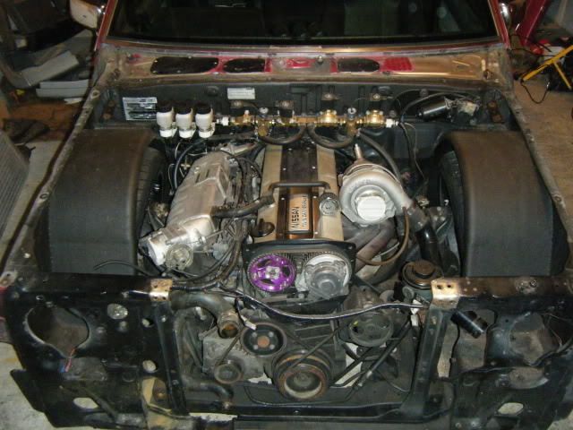

Like removing the factory inner fender and welding trailer fenders in, but higher up than the factory inner fender for more clearance... I got rid of the plastic fender shielding a long time ago... This is what I'm talking about
