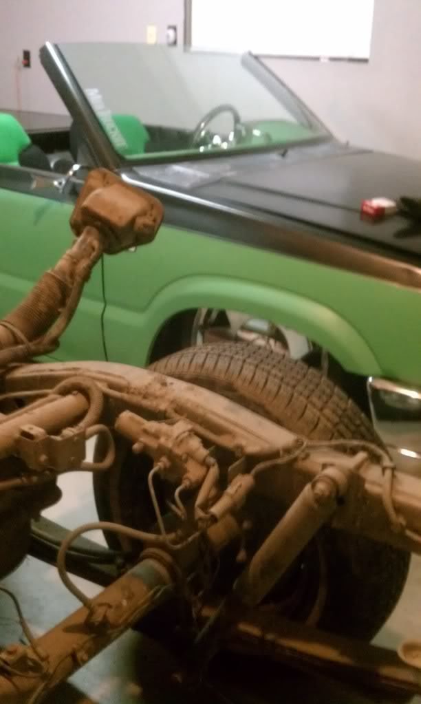

Hey guy's i need help getting rid of my ABS i got a new truck that i will be doing a build thread on but have never messed with it and i dont need it!

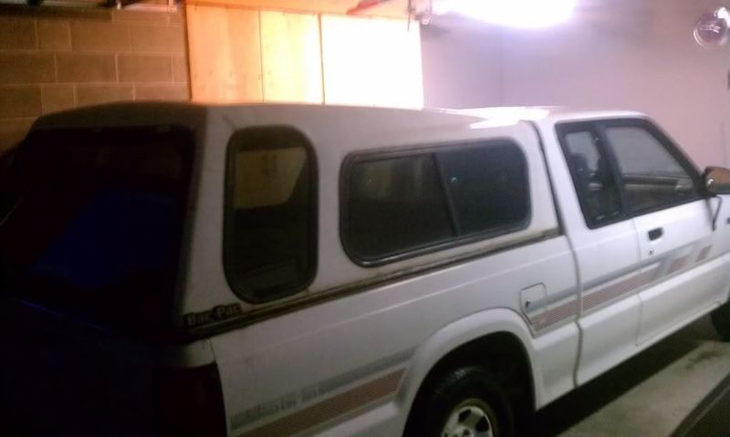

The new Truck oh yea its my first Automatic......

Will it be in the way?
ABS would be quite handy on a rear of a truck
If it's not in the way you can just unplug it (someone correct me if I'm wrong).
It'll still continue working but won't be proportioning between the 2 rears.
I think these only had rear ABS? (again correct me)
So it shouldn't affect your front/rear proportioning.
Looking forward to the project
jc50942
the proportioning valves are in the abs module as far as i know...but unplugging the power to the motor shouldn't have and effect on normal braking. But if the whole apparatus is in the way...just get the routing, figure out which line is which and take the whole thing out and put in a variable valve...they are cheap enough...just have to play with the adjustments to get it set just right.
sincitylocal's avatar
sincitylocal
Correct again.
It isn't a proportioning valve though... it is a high pressure piston/valve assembly that pulses to avoid lock up.
jenko
lol, probably shouldn't have used "proportioning", especially in 2 contexts.
tucknrimmaz's avatar
tucknrimmaz
just take the line thats going into the unit and thread it into the rubber soft line. Done. Did the same thing on my 1990.
