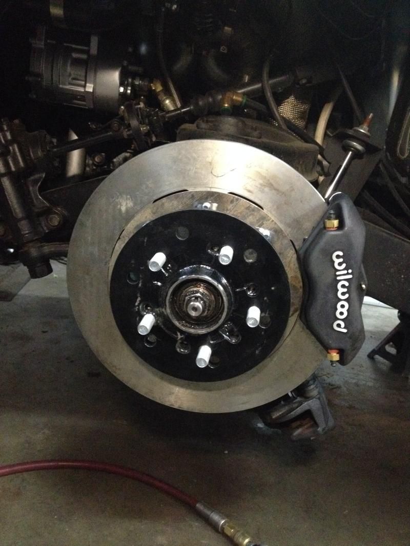

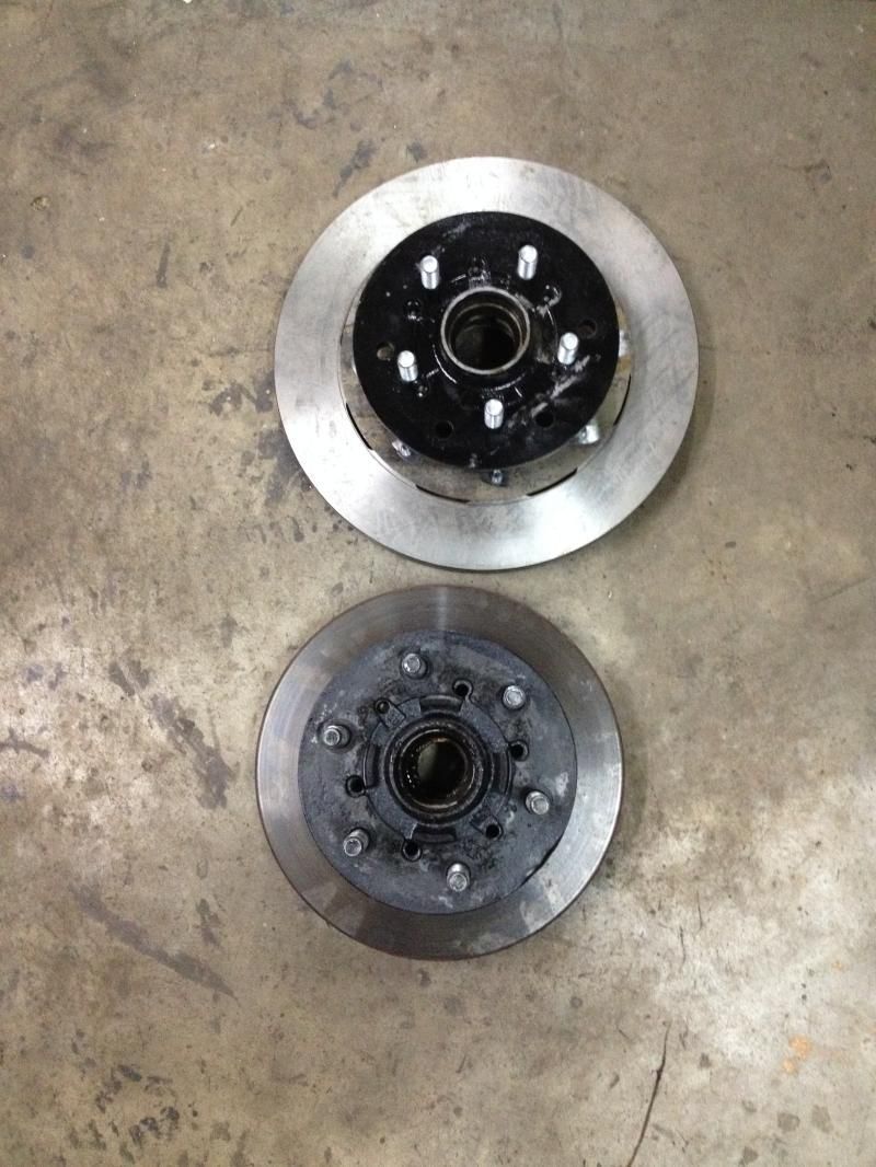

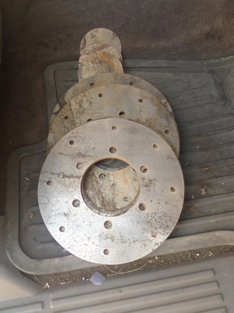

I posted some of this on mazdatrucking but I know some of you aren't on there. I drew up an adapter and had some cut out on the waterjet to run a wilwood 12.19" hat mount rotor. They bolt where the factory rotor goes and you mount the new rotor to the adapter. I wanted to go with a bigger rotor but the price of the rotors went way up so these will still be a big improvement over the stock brakes. I'm going to use the wilwood dynalite 4 piston calipers on mine but really any caliper that will fit on a .81" wide rotor will work. Here's some pics

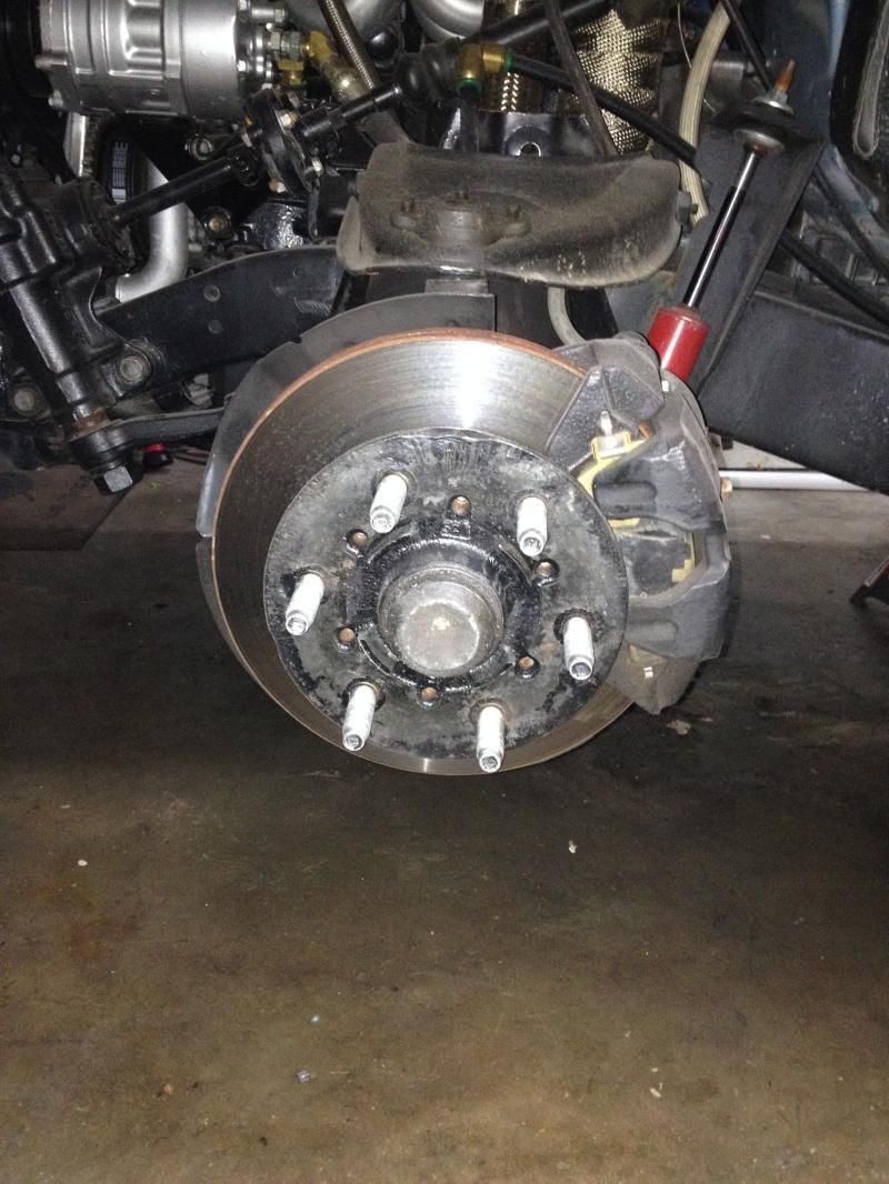

Here's the stock for comparison

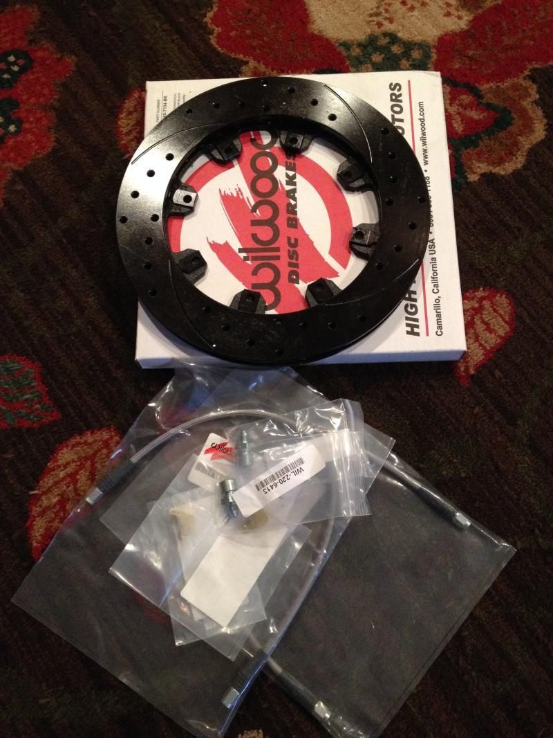

New stuff
If anyone is interested in doing this it cost me $20 each to have the adapters cut out plus a little over $5 each for the steel. I had 5 pair made. I'll sell a pair for $50 plus shipping if anyone wants a set. The wilwood solid rotors aren't bad about $35 each. I bought some then decided I wanted the drilled and slotted ones to match the rear.
Here's a parts list with prices for everything I'm using in case anyone wants to get an idea what the whole package would cost to do. These prices are from Wilwood's site and are cheaper if you search summit, jegs or ebay.

The drilled and slotted rotors

I had them made at a local waterjet place. I have the cad file so I could have more made
