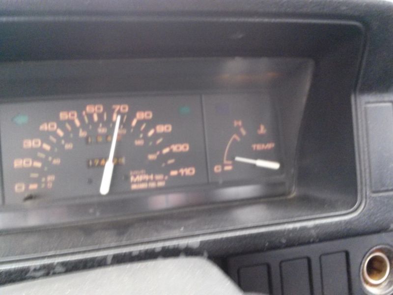

87 b2000... I'll try to get a pic in the morning when I leave work but about where should the temp needle be after warm up? Mine goes to the middle but after being there for about 5 minutes, Maybe not even that long, it drops down close to the notch above cold.... only reason I'm asking is cause my heat sucks and if a back flush doesn't fix it then I'll need some guidance lol Thanks

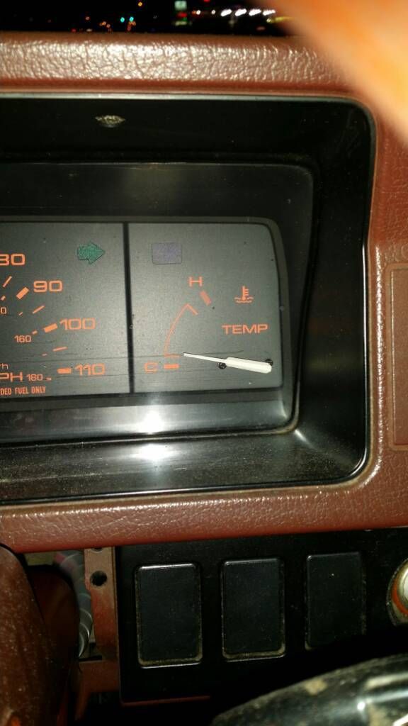

I spaced on the pic, spilled coffee all over the place... I'll mess with it this weekend Hopefully. Thanks for the replies!

Hopefully that pic worked.
Cusser's avatar
Cusser
That needle position is OK this time of year, that's where mine rides.
I just took mine 60 miles away on Sunday on Interstate, 85F outside, but didn't pay attention where the needle was.

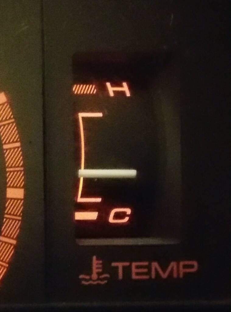

Mine may not be too relevant, but on my 13B, and stock thermostat (180 degree I think), I run about 1/3 of the way into the normal range, usually the needle is just touching the bottom of the temperature icon, and that is in -20 weather that we are having right now, I have yet to block off my grille yet. During the summer, I was from 1/3 to 1/2 on the gauge. When I had the stock motor with stock thermostat, it was about 1/2 on the gauge. I would change the thermostat, its quick and easy, may as well use a new rad cap too, should be under $50 and an hour labor for all of that.
