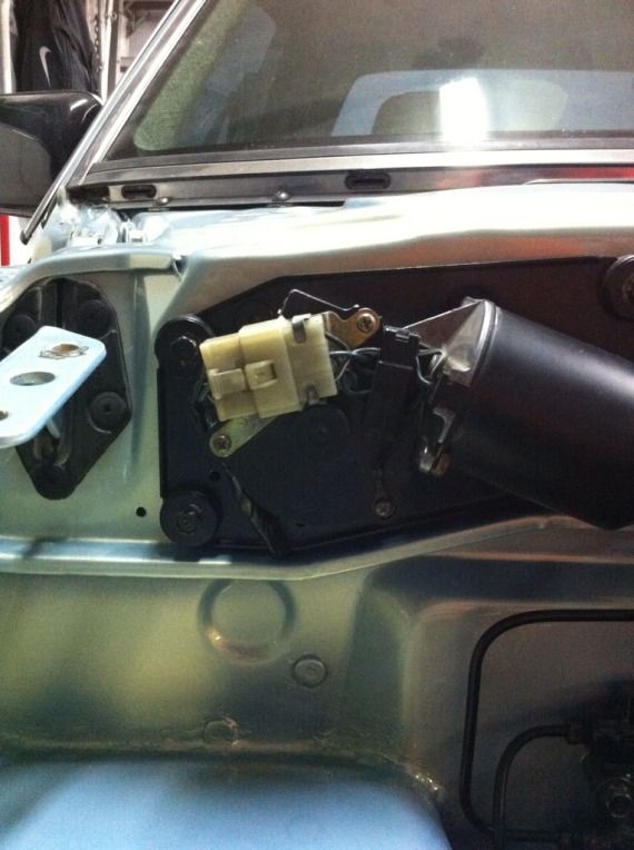

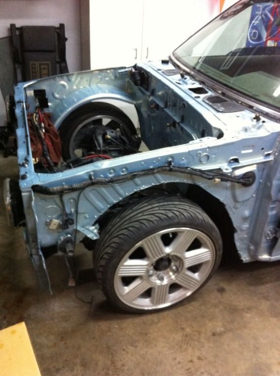

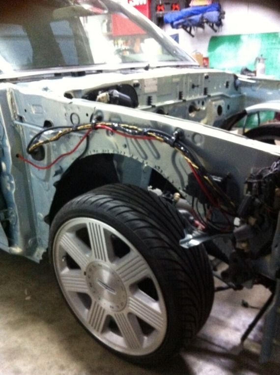

This is great info!! I went to the hardware store and got longer wire and sort of lengthened mine but I'm scared it's going to break every time I open the hood.
Here's some pics of my wire tuck

Ill have to look into rerouting the cable like the one in the link. What is the little white thing bolted to the fender? I bolted mine back up but have no idea what it is. Only wires I have to lengthen is the brake res, and washer bottle. Im also having to redo my pos battery cable since i mounted mine to the batter tray.
mazdizzle
That white square thing is ground wires. I'm not running a brake fluid sensor but I did have to lengthen most of the wires on the passenger side. My fuse box is hidden under the fender so you barely see any wires in my engine bay.
