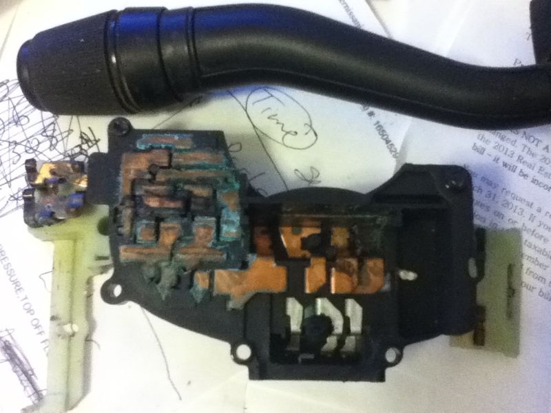

P.S...All my turn signals and spray washers don't work either,so I'm replacing the the multi-switch lever assembly on the left of the steering wheel to see if that resolves the issue.

Now for the the hazard light, they work and I have also swapped the flasher module and the turn signals still
did not function.Fuses in the cabin are all good.
I just got another multi-swich turn leaver & will see if that helps with the signals.

Turn Signal was Bad!

That turn signal switch looks horrible - any way to just clean off the corrosion (like soaking in vinegar) then cleaning it up?
E
emjay
baking soda and water will clean that right off, then hit it with a clear lacquer to protect it.
