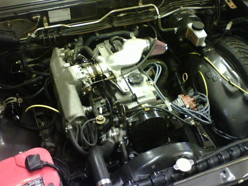

I've got 4 of those bongo engines and one FE3 engine. My daily driver has the exact engine that you have a pic of:
I'm running Megasquirt on it and it works fantastic.

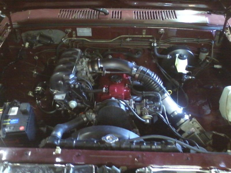

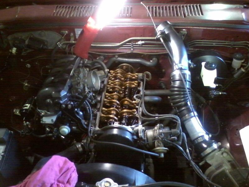

My other truck is a project that I'm still working on but I have a bongo engine with the 929 manifold:
This one is running a Mazda 626 ECM conversion which was developed by my friend Madlowmazda Jim.

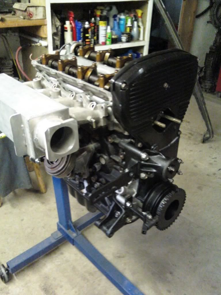

And heres a pic of the FE3 I'm building for yet another future project:

Man I would love to. Thanks for the invite. I would love to just get a little more out of the b2200 with out a crap load of mods. The 12 valve and carb should give me a little more than the 89hp stock. Hey I'll pm you
By the way guy, that engine bay looks sweet!!! How dose 12v compare to the 8v on spped and performance? I would love for my truck to break the 100mph at least one in its life....lol But real looking for better performance while keeping the fuel mpg up. I get 32 hwy.and crap in city becouse I punch the living crap out of the pedal. I wen't from Marysville to Medford, Or. two tanks of gas there and back 498 miles.

The "bongo" engine that I built with the 929 manifold and the red valve cover is actually a 2.2 out of a 626 with the cam and cam backing plate replaced with one from a Bongo engine so that the distributor and thermostat housing are in the front.
I think that my dailys 2.0 Bongo with MS is way faster then it was with the old 2.0 8 valve engine with a Weber but I dont think I'll be winning any races with any of them.
