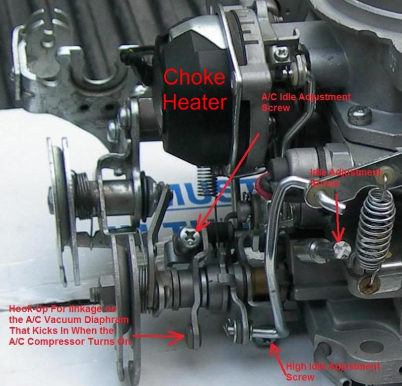

axel breaker earl
Here ya go!
Just back the screw out while it's on high idle and lower it to around 1500-1800 rpm.......if your in the great white north, you may need it around 2000 rpm so it won't die on you as it starts to warm up.
