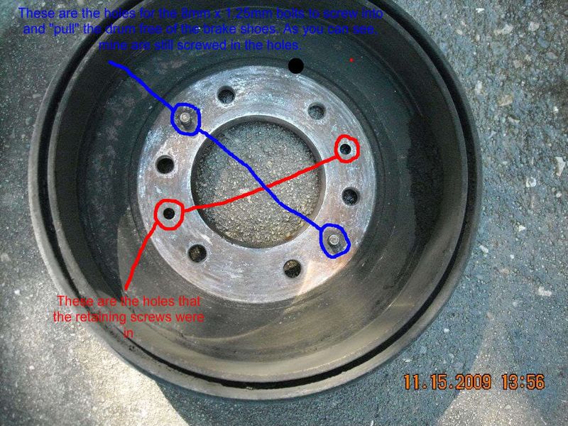

Use the Bolts cusser said to use they do help trust I've done it and it's the fastest way but tie they with a ratchet evenly if not ull crack the drum
axel breaker earl
And a picture to further explain the responses!
