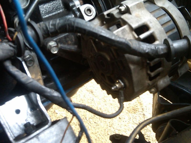

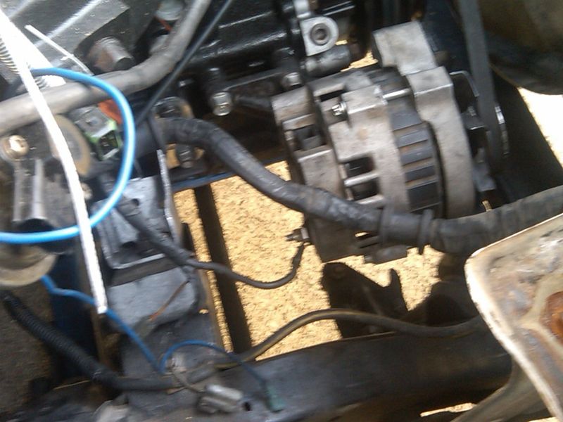

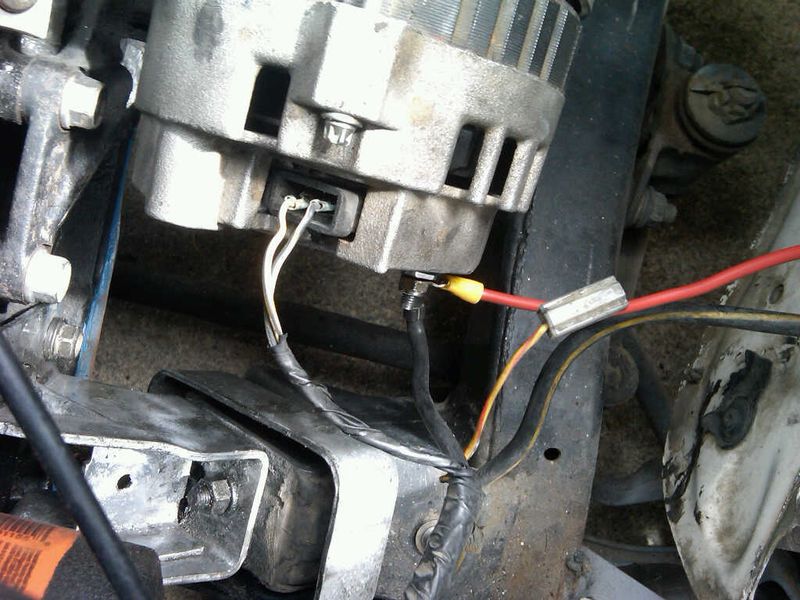

OK so here are some pic's that i took

Okay you are missing a male two wire plug I think, it goes into that black rectangle hole.

THis is what i did;
i pluged in the cable from the original alternator to the rectangle
and i ran a 10gauge wire from the alter.. post to the battery but it still dose not charge. so ill try doing the 0gauge wire. see if that works.

U may have the wires in the wrong places also may have wrong wires...And are you sure that alternator is good? I've bought brand new parts that were defective so if it's used, take it to Advance or AutoZone and have it tested...BTW 0 gauge is jus to insure that you're getting maximum current from the alternator but it should still work with 10 gauge...

On that two wire plug one of them needs to be ignition and the other I believe goes to the batt light on the dash or it could be a sensing wire. Since the alt is internally regulated the sensing wire will tell the alt to increase it's output. In order for the alternator to start charging you have to excite it that's why you need an ign wire. The gauge of the wire coming out can be 8awg or better increasing the gauge does not make it charge more it just reduces the resistance and voltage drop. Let me see if I can find some info for you.
Worst case use the Google.
