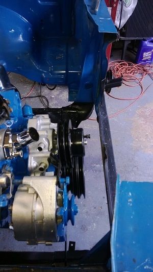

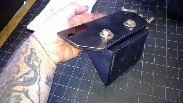

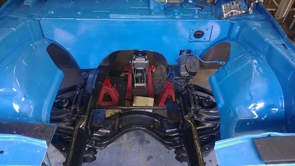

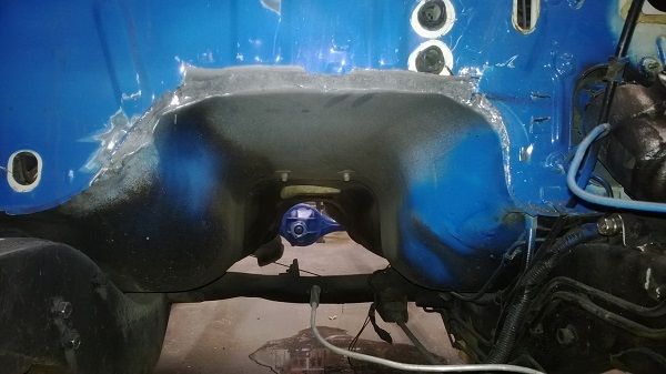

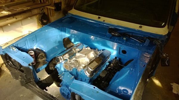

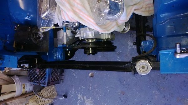

jpneal84

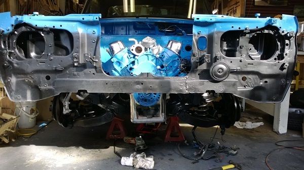

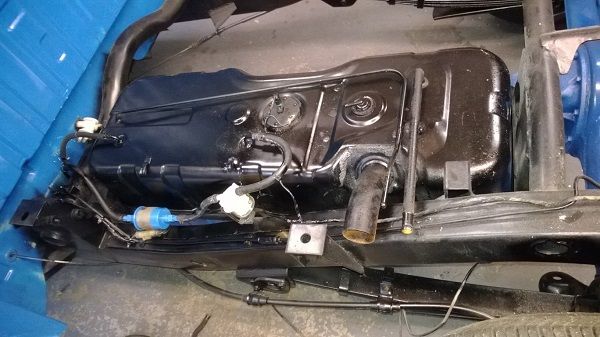

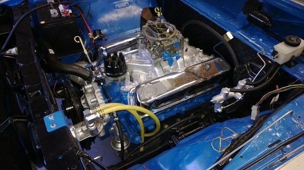

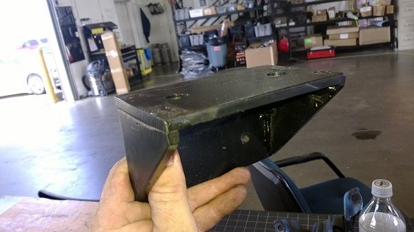

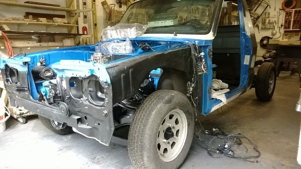

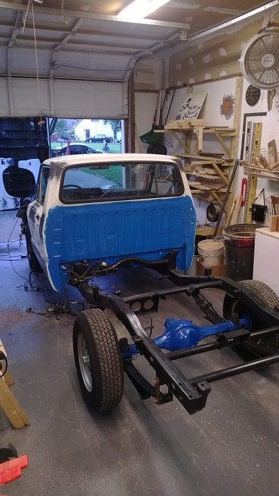

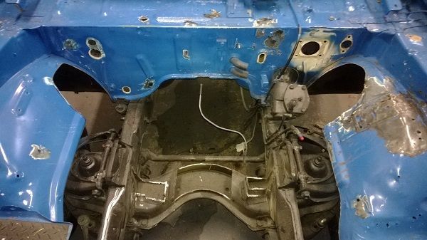

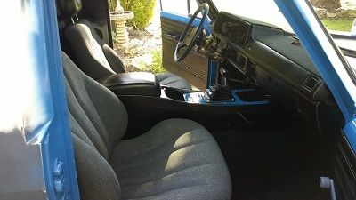

long time no updates, I know. up to now I have an all new gauge panel with all new gauges set to install. Speedo, Tach, fuel, volts, water temp, oil pressure, vacuum. picked up a set of 8x15 chevy rallies and painted them to match the ford blue of the truck. added deep trim rings and some new BFG on the back. 275-60

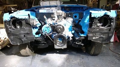

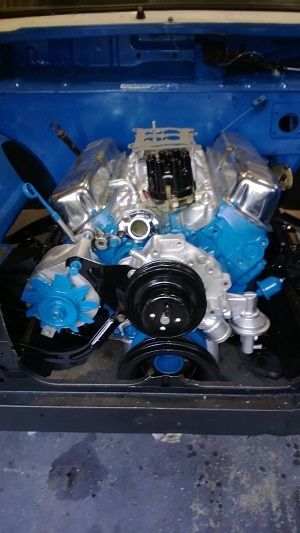

started forming the custom exhaust starting with a set of 72 cougar cast iron manifolds and mounting them turned forward. routing the tubing with a 180 bend and back and down through the front fender wells. they will go through the body support member and into sausage mufflers before turning out in front of the rear tires. added a set of 95 gran prix hood vents to add fresh air right over the exhaust. about ready to start it up and hear it run.

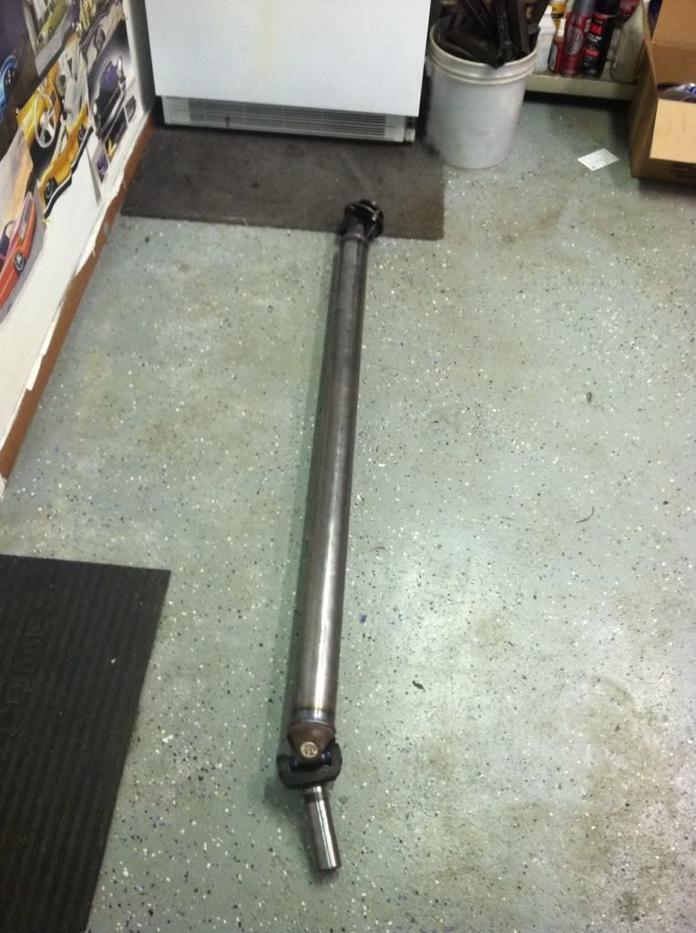

jpneal84

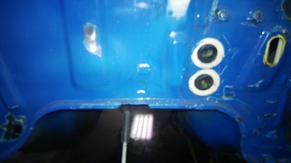

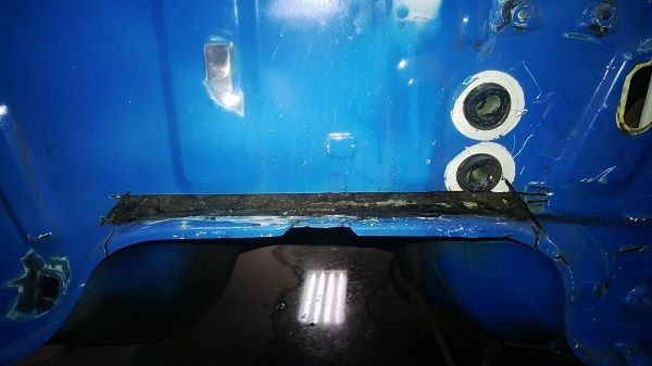

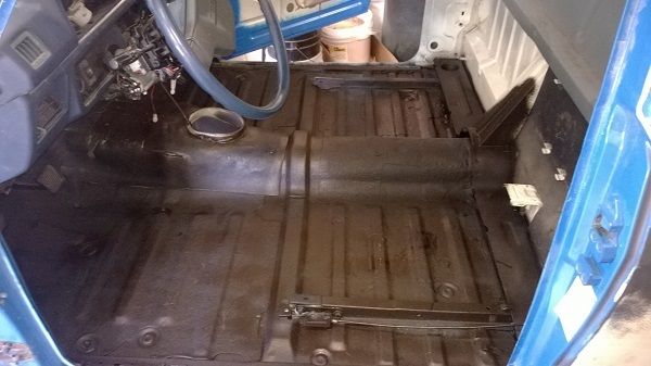

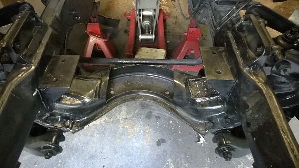

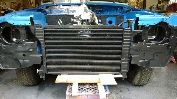

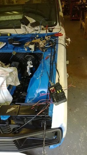

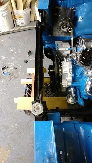

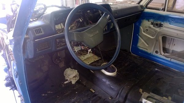

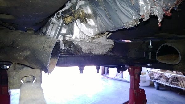

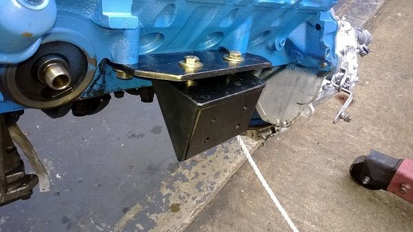

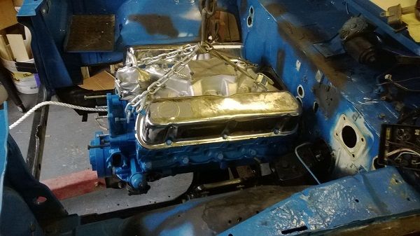

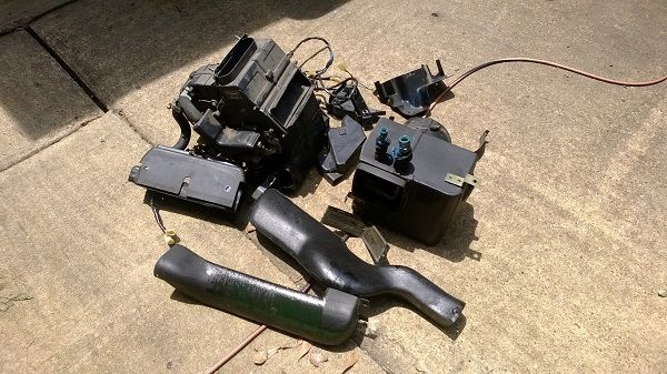

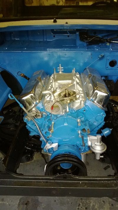

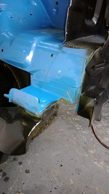

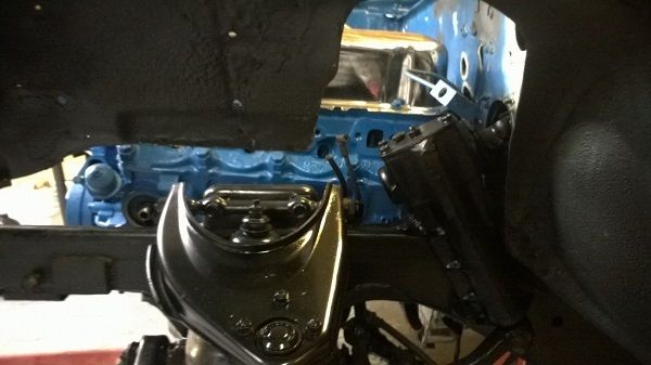

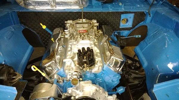

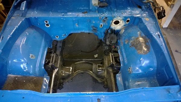

couple updated shots
