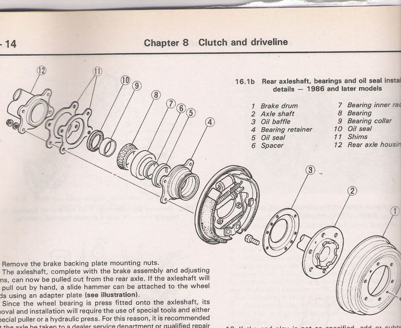

Here is a blown up view of the rear axle to show the parts in detail so it makes better sense.I had posted this up over on mt in the wear and tear parts thread wayy back.Ok
