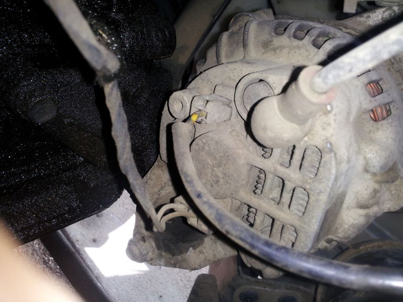

Here's the back of my alt. The wire is the yellow one with the lil plug on it

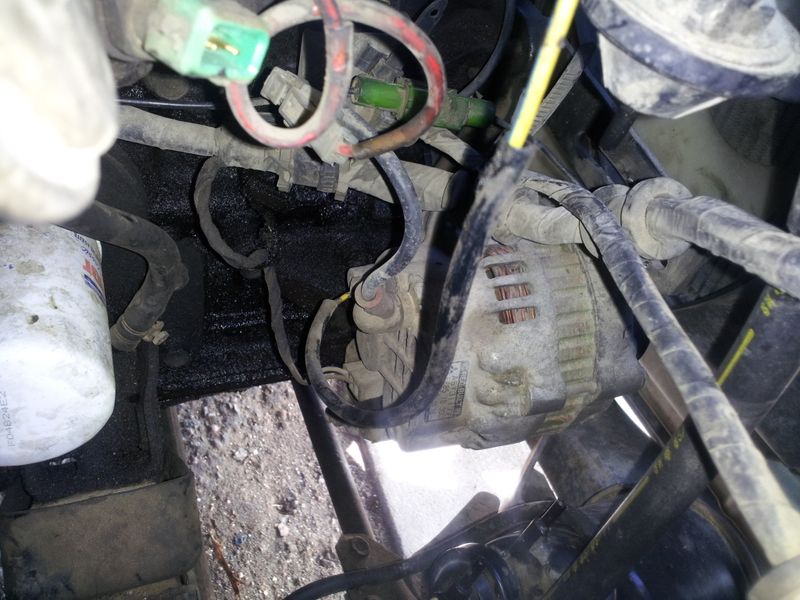

Here's a view from further above...
I hope this helps ya I honestly have no idea where the oil sender even is so I can't really help with that one but I hope u can eliminate the choke wire problem,

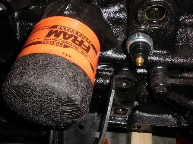

Thanks man. The oil sender is actually right next to the oil
filter on the right side. Right on the side of the engine block.

The oil sender is next to the oil filter on the right.
Use a thread sealant to ensure no leaks.
